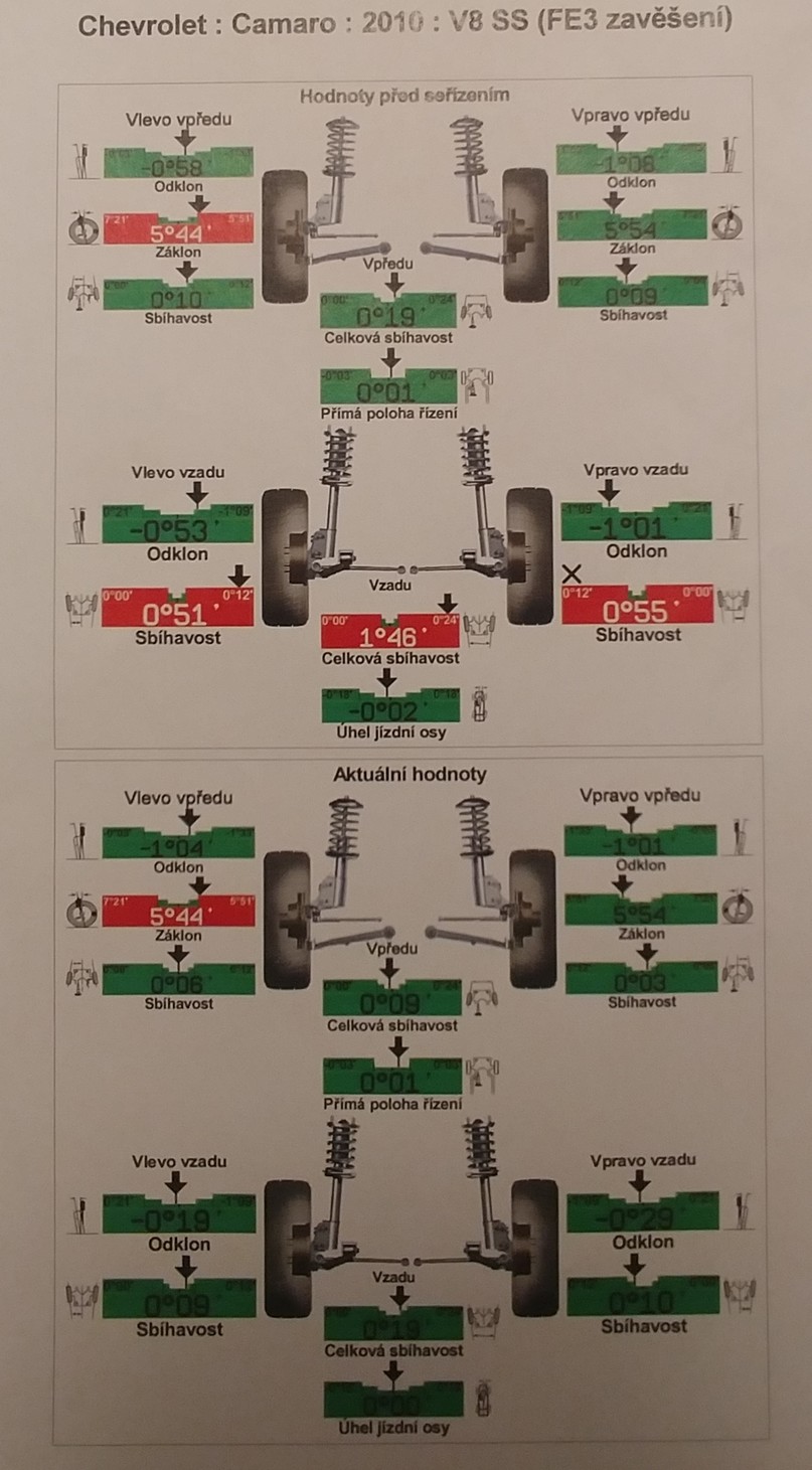

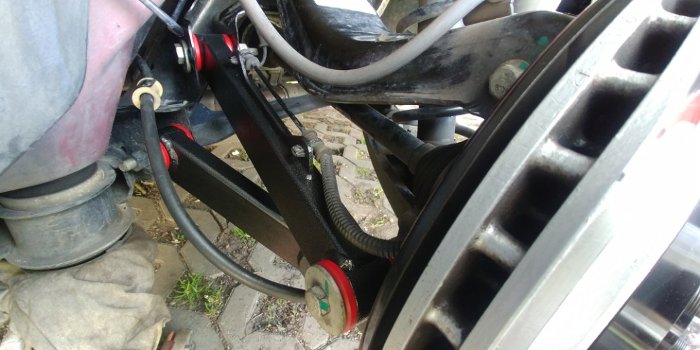

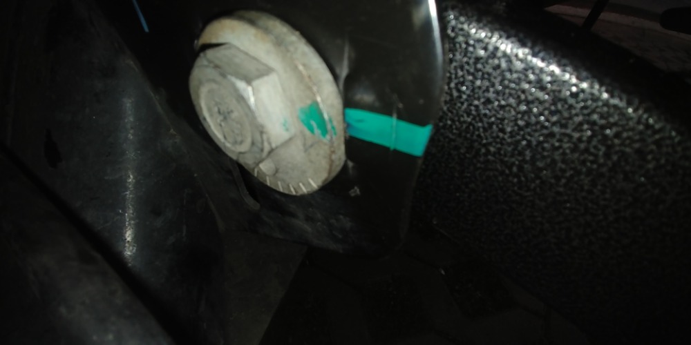

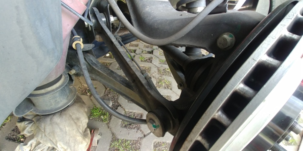

You don't rely, I hope that after marking the starting position on the eccentric pad, you set the geometry of the rear axle back correctly...

Originally Posted by FasNuf View Post
I took the car to get a 4 wheel alignment. I don't rely on the factory alignment either. You never know when the aftermarket toe rods are shorter or longer center to center as well and I didn't bother to measure it since I knew an alignment was coming. I knew the alignment was off because the tires were so worn in the toe, so the new suspension parts weren't to blame, but still could've been off. Here's the video on that.
https://youtu.be/odPRr0xyCC4
Exactly.
I write this because I made the same adjustment a few months back.
Even after marking the starting position, I was completely out of the geometry graph.
BMR has great products, but I think they made a mistake in what they write in the manual.
Many people will rely on the instructions and if there is no accident, owners will not like BMR. Because the car will behave worse.
George-CZ is offline   Reply With Quote

Originally Posted by George-CZ View Post
Exactly.
Yes, and if he lowered the car things start getting really screwed up. The instructions for the toe rods and trailing arms were mediocre at best. Like I said in the video, they said to mark the eccentric bolts with chalk...who does that? They never mentioned about clocking the bushing with the suspension loaded either which is a good idea.

Wow, I dont read the language, but I can definately see the red! Good thing you got that checked out.
When I came back from the alignment, I crawled under the car to see how much he moved my eccentric bolts. To my surprise the passenger side wasnt touched even though my toe was out on that side. I called and he said the camber was out and when he moved that back to spec, the toe followed in line. It all works together.
