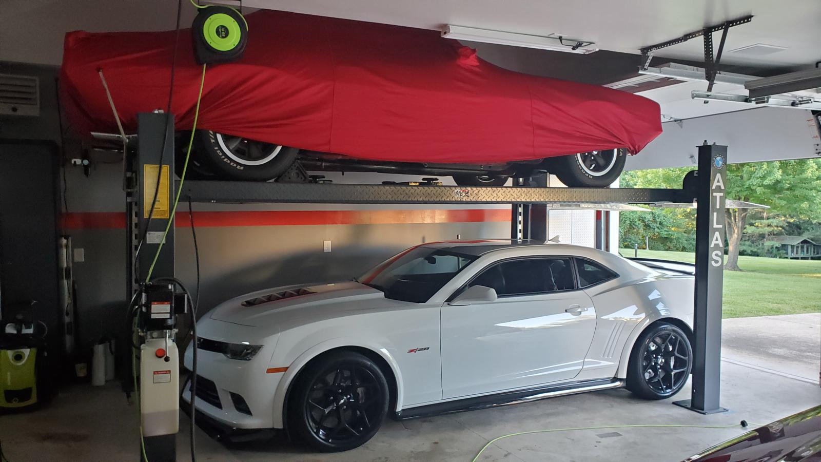

My Atlas 408-SL

Originally Posted by 72 Z27 View Post
My Atlas 408-SL
How close is the mirrors when parking 5th gen under lift ? Looking for a lift to buy
Two_Tall is offline   Reply With Quote
I don't have an exact measurement but 3-4" on each side to the support columns. For a 5th gen Z, I would recommend an extra wide type 4 post. The tightest clearance on my 4 post is clearing the tire/wheel while pulling on/off the runners to the pulley covers for the braided wire rope in each column. My tires hang off the runners about 1" on each side....these cars are wide.
Jeff
72 Z27 is offline   Reply With Quote
Is your Atlas 408SL considered extra wide? I like yours and looking for a lift as well
ZED/28 is offline   Reply With Quote
This is really good advice. If you have room, purchase the wider 4-post.
No, the Atlas 408-SL is the standard width. If sticking with the Atlas brand, the 409-HP is similar but extra wide and extra tall.
Jeff
