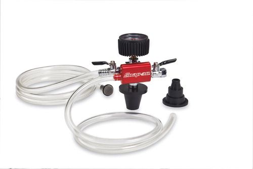

I use this bleeder anytime I am refilling any type of cooling system It pulls a vacuum into the system then sucks in the coolant eliminating any air pockets.
