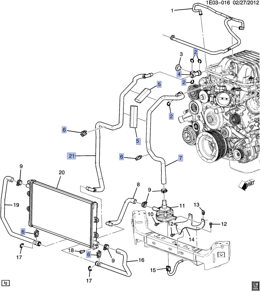

i am trying to focus on what is needed to convert to 1" hose and not leak coolant everywhere.
what all needs to be replaced? 21,19,16,8,7? and all bends and couplers and clamps? do you need to do anything to the pump or intercooler in and out to accommodate 1" hose over 3/4"?
Assuming you did the math calculation that the current pump is going to push any more fluid through a 1/4 diameter increase against the head pressure in the systems.
**did you mean ISNT going to move more**. and that was my thought is upgrading to 1" over 3/4 on a system built for 3/4 without upgrading pump and intercooler is not going to net any results. any idea how much HP the 3/4" hose keeps up with until IATs spike to quickly and take too long to come back down?
Yes I meant the bending of the hoses are the issue with the Head Pressure more so than increasing the diameter of the hose by 1/4 inch vs just getting a faster pump. Here are two good URL'S to read.
https://dedicatedmotorsports.wordpre...ump-flow-test/
https://ls1tech.com/forums/forced-in...g-results.html

Another option over a faster pump is running an additional pump in series with the existing one. I have one on each side of my heat exchanger.

ok for now i think i am going to just order it with the stock size lines and upgrade the pump when i go more pully and e85. thanks for the data.
