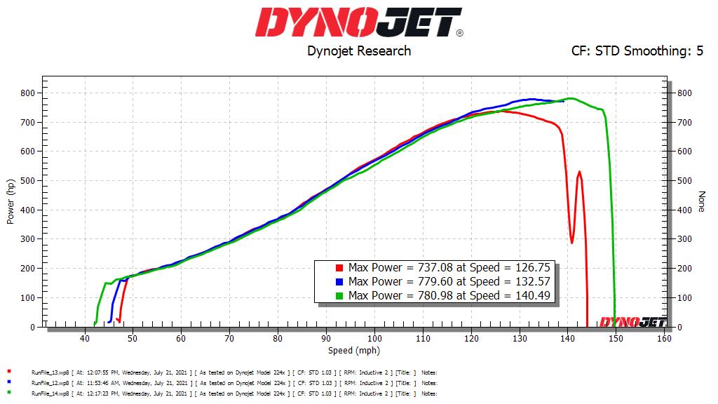

I have the ESS tuning G2 running the 110mm pulley at 12psi on my 2014 Camaro SS LS3. I put down 780rwhp at 7200rpm on a Dyno jet, I am running 93 pump gas with boostane at 100 octane.

That's great power output from the smaller G2! Especially with that large of a pulley. Which lower pulley does your kit have? The 200 or 207 mm? Great power for 12psi.
Thanks man! I'm running the 200mm lower pulley. I have the additional 100mm upper pulley as well in the box. The performance shop that I got the car dyno tuned at was mind boggled as to how the car made that much power on just pump gas with nothing more than 1 3/4" longtubes, cam, and stock catback.

Car looks great, if I went with a centri I think I'd use ESS. How much torque did it make? Any guesses what it'd make on 93 only?
I wish dyno operators would use RPM instead of speed :P
