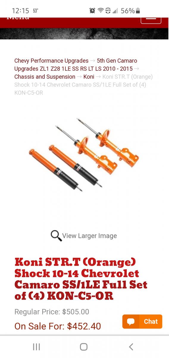

Gotcha - What part number are the Koni’s?

Originally Posted by rich2342 View Post
Thanks rich2342. I'm trying to find something that will help with the drag set up so not sure what I will be doing just yet.
