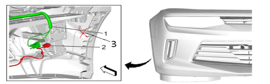

I posted this on the "DIY How To" area a few months back, but I never received an answer to my question. (Other than take it to the dealer....) So I'm posting it here hoping this area might shed some light... (pun intended)
I bought an LED Bow-tie from a Chevy Dealer (Part No. 84329529). The part fits the 2020, but the instructions are for an older car (printed 2018).
The light comes with a "splice harness" that gets plugged into a junction box behind the passenger's side of the bumper. When I look for the junction box (reference in picture,) I cannot locate anything electrical in that area. The only thing I have there is a plastic honeycomb box as part of the bumper.
Any ideas where the jumper plug wire gets plugged into for a 2020 3LT?

I remember your thread from a while back, sadly don’t have any idea where to splice it.
But from what I’ve seen, the bow tie is just powered by one positive and one negative wire, you could splice into any power nearby I believe
It's suppose to be plug and play... Without pulling off the bumper, grill, and wheel well liner I don't know where that plug is. The pic in the instructions don't seem to match mine.

It appears to be on the driver side on your car not the passenger side. Maybe the following link will point you in the right direction.
https://www.docdroid.net/9luD7mq/201...ns-pdf#page=10

Cool, I'll have to check it out. Makes sense because I cannot find anything on the passenger side.
That worked! Interested how they changed it for 2018 to 2019 and 2020.
