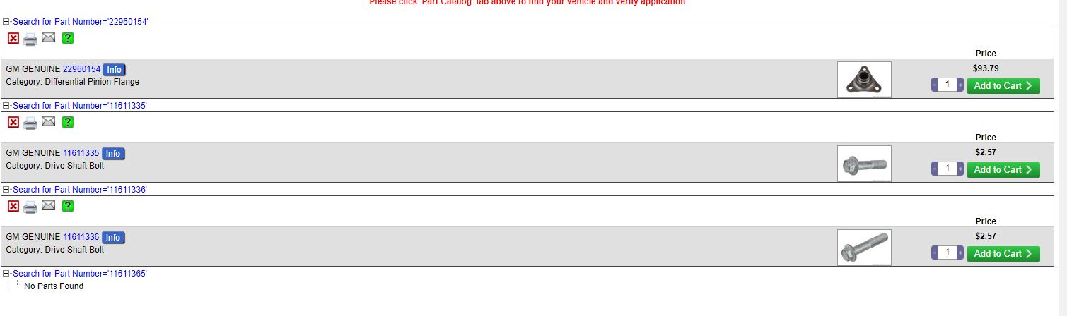

Rockauto has it all but the nuts. Look it it by part number. Unless there is something strange about them you can probably pick them up from McMaster-Carr, Grainger, Fastenal or other fastener supplier. Of course you could get bolts from them to once you determine diameter.
gtstorey is offline   Reply With Quote
Attachment 1077428
SWEEEET! I could only find the flange the way I was searching. Thanks man!
