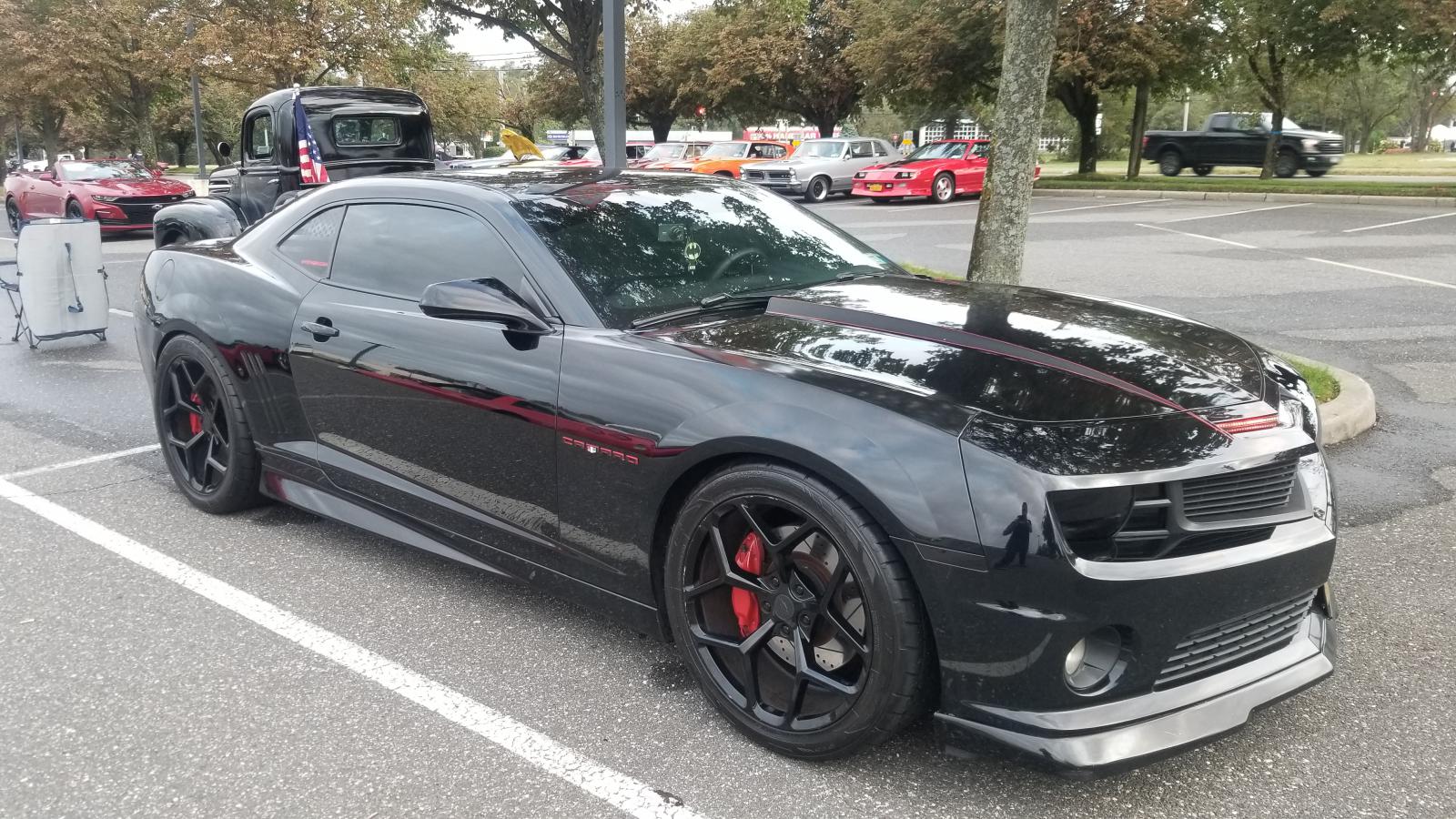

My 2010 on BMR 1.25 drop and slightly oversized tires from stock
2010 2SS/RS "The Mistress"
Color matched OEM GFX / VIS Carbon Fiber Hood (absolute trash quality and customer service ) / Heritage Grille / 5% Windows / 30% Windshield tint with 5% visor strip / Tinted Exterior Lights / Streetfighter LA Spoiler / Morimoto XB LED fogs / LED sidemarkers / Airaid CAI / Hurst Short Throw / TSP LT's / No cats / No resonator / Corsa Xtreme Catback / Trifecta Tune / Factory amp replaced / 2 JL Audio 12's / MRR 228 Wheels / BMR Springs / Koni Yellows / R1 Concepts Rotors & Pads
