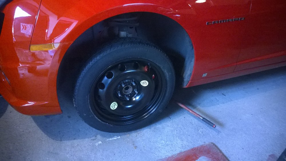

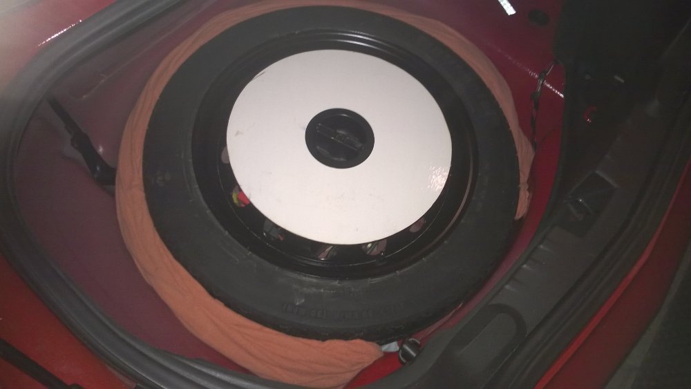

I bought a spare wheel from a BMW X5 and put it directly in the trunk under the carpet.
Given how many times I will or likely will not need it, so instead of a full with full wheel trunk, I will swap the front wheel behind the rear wheel and put the spare wheel on the front axle.
There is no need for spacers and it will fit through the Brembo brakes.

Originally Posted by CPCNY View Post
I just use a stock wheel. The spare kits can only be used on the front since they are smaller diameter tires.
Nice job securing the wheel properly. An unsecured wheel can cause serious injury in a collision.
This is exactly the setup I had for a while (including shop rags) on long road trips. Frankly, I gave it up at my own peril after about 7 uneventful years.
The last thing I want is for that wheel to come crashing forward in a front end collision. The first law of motion in physics can be a killer.
