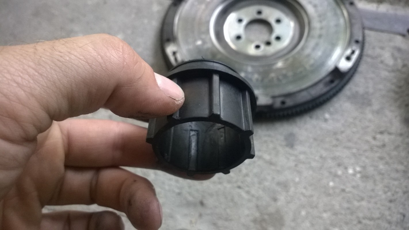

"I am not convinced you need the bearing support. Pretty sure thats a waste unless you’re serious about drag racing and putting a ton of heat in the clutch."
My friend's acquaintance...
One invitation to an all-day trackday on the circuit was enough and the support collapsed after warming up.
I gave him mine what I took out of my bearing so he could sell the car in a rage.
He never raced with it and didn't even want to race.
He was just learning to drive his car safely under the supervision of a racing school instructor.
He now has a 911 Turbo.
My life is a constant struggle with Camaro.
Attachment 1092685
Cool story, but it sounds like your buddy is more of an automatic guy.
Also, you completely missed the last sentence of my post. Go back and read it again because i think you’ll realize i agree with you for track use. Noob.
2010 2SS/RS
Z/28 intake, NW, FAST 102, speed engineering LT's, some exhaust, ATI -10% pulley, GM flex fuel injectors, DSX flex fuel sensor, MGW shifter, HP Tuners, some suspension work, stickers and a little weight loss. 12.63 @113.53
xc_SS/RS is offline   Reply With Quote
Old 02-25-2022, 03:46 PM   #36
George-CZ
George-CZ's Avatar
Drives: 2010 2SS LS3 and 1978 STROKER 383
Join Date: Feb 2018
Location: Czech Republic
Posts: 1,611
Of course I read it to the end.
And I certainly don't mean it badly or sarcastically
I don't know the boy very well. I only talked to him a few times and he was on a ride with us a few times. But as far as I know, he always had beautiful cars and always preferred manuals.
And it didn't seem to me that he couldn't handle the clutch.
In addition, he had an instructor next to him.
He had a Camaro as a joy car.
He never raced with him - basically he just went on a circuit with him for one day after the boys invited him.
And it's just sad not to be able to use a sports car on a sports track, because the clutch bearing support can be damaged.
You can break the car, burn the brakes, burn the clutch plate, rip the tires, boil brake fluid. But this thing just can't break when I'm going fast ... simply put.
The bearing is heating up and therefore I think it should be on a heat-resistant base. That is all.
