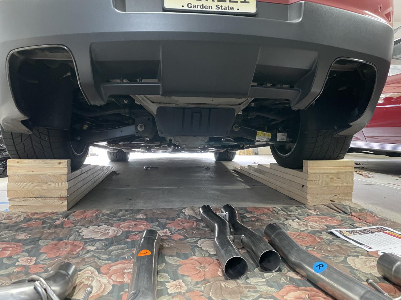

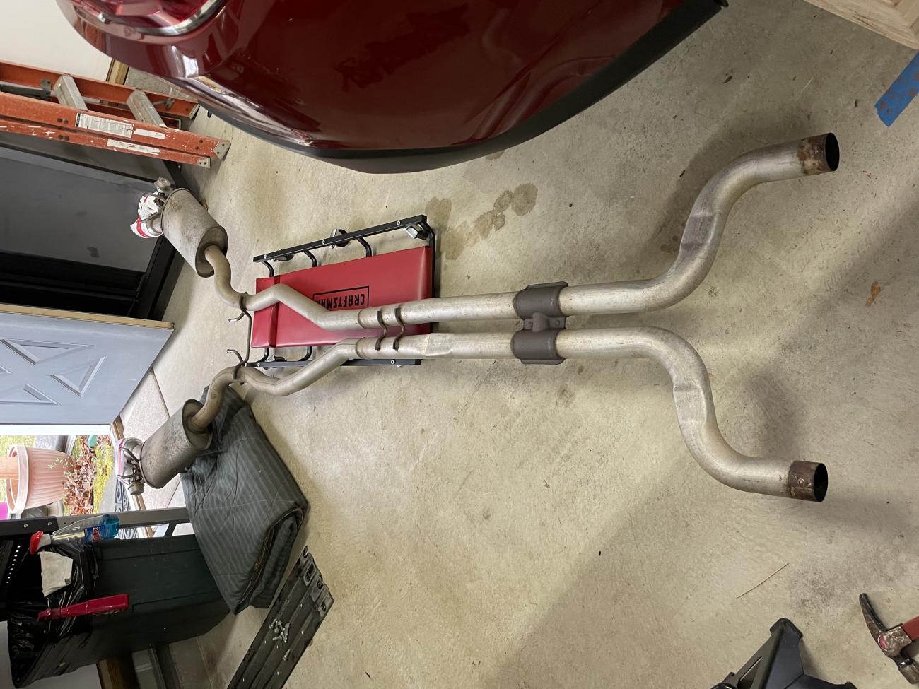

Did the removal of my stock exhaust and took off the convertible braces and got ready to mount the Borla. Just looking at everything out of the box and with the stock taken off it looked like it would fit.
Got everything mocked up and put the braces back on. IT WORKED!!! Everything fit, and there was plenty of clearance. The extra brace closer to the cats has almost an inch of clearance and the diagonal bars in the back weren’t even close. That’s the part I was worried about since the pipes bend back there. I emailed Borla as well to let them know too.
I will probably end up buying the stainless works kit anyway just for more clearance and a little breathing room but I’m happy to report that the ATAK catback fits the Convertible Camaro ZL1’s as well without any modification.

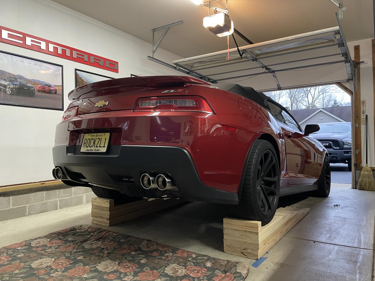

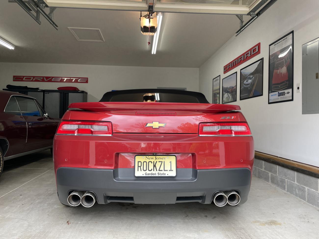

Hope this helps even one person!!! I still need to move the tips in a little bit, but that’s me installing, not the system. Anyways here’s some pictures of the install:

It sounds great. When I did the first startup and cruise I wasn't sure, but then as the days went by its starting to sound better and better because all the coating on the inside is going away and the carbon is starting to build up.
Its probably a little deeper than stock at idle and then louder when full throttle. The sound is clean, meaning all tone and zero drone. I had previously done a fuse pull but wanted a lil more. This is probably as good as you can get without doing headers and more. Theres a lot more pops and crackles. It's a hilarious wide smile you get when its crackles as you let off.
Overall it's not as loud as I thought it would be, coming from ATAK on my others past cars, however, I don't regret it whatsoever.
You're very right, it's definitely a lot of money to spend on a chance, but I didn't pull the trigger until I felt pretty good about it.
