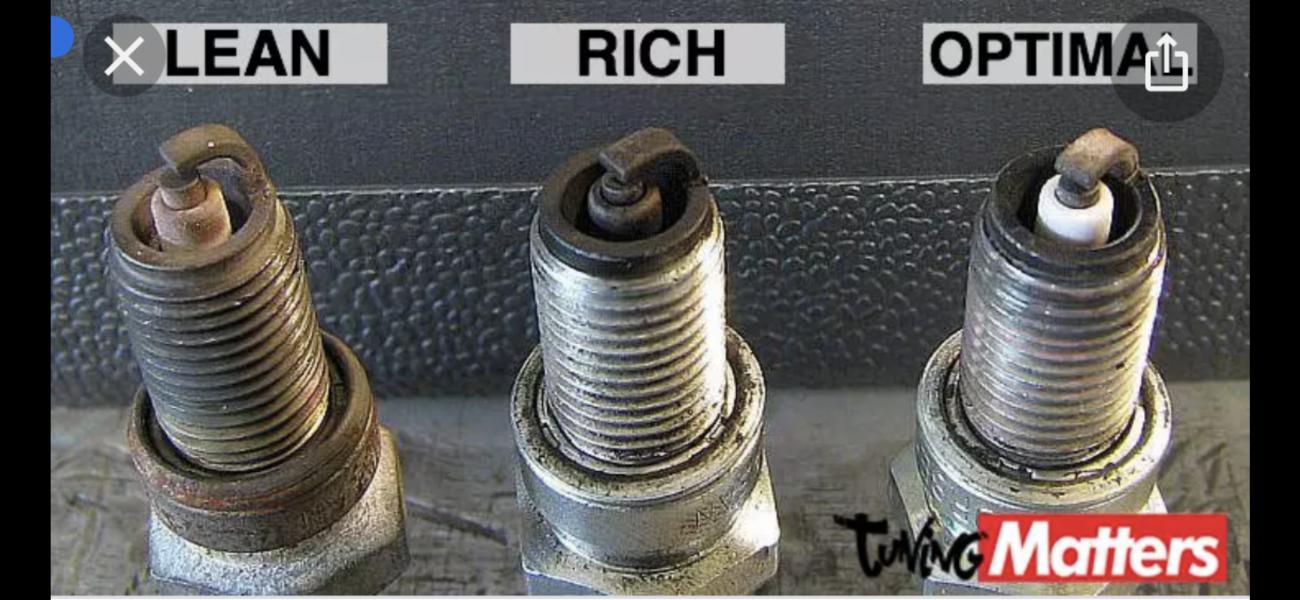

Looking at some of the classic plug color charts, they might indicate being a bit lean but not sure I’d call them ‘fouled.’
Attachment 1102447
I can see that, thanks
