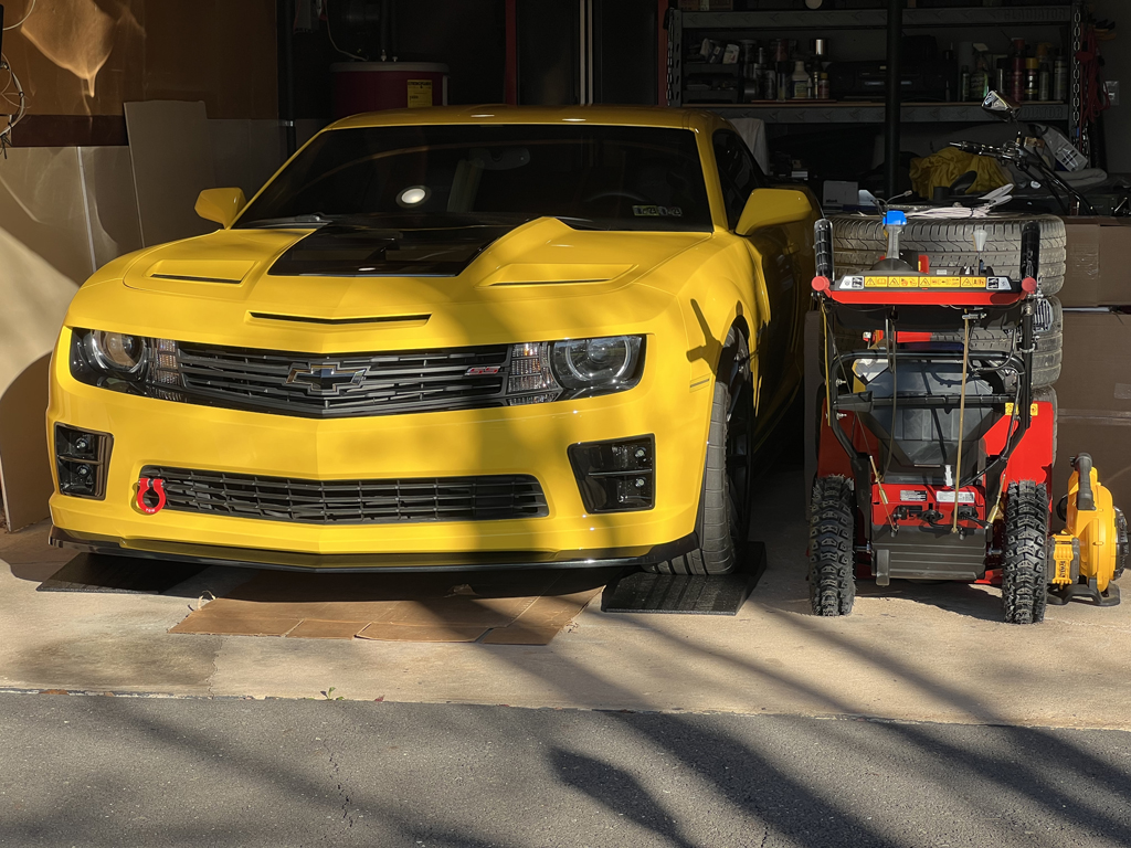

Thanks man, I really appreciate that!
I spent the day washing/waxing (went old school with American Wax) and finally was able to get out to a local car show yesterday evening.
Name:  2022-05-17 18.00.50.jpg
Why is it always such a challenge to back straight into a spot with these cars?

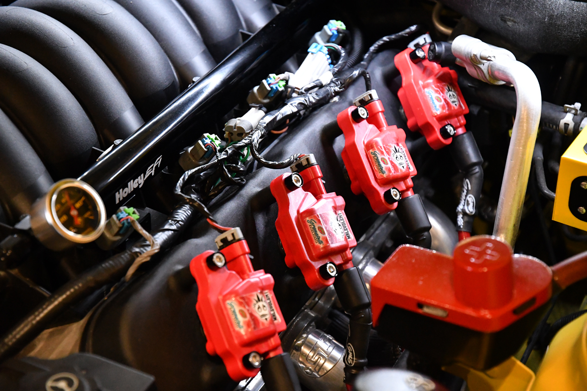

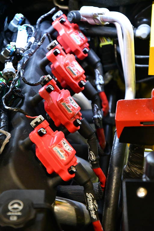

I have had a new set of colored wires on my list for awhile, so I ended up installing a set Granatelli’s Malevolent Coil Packs and their 0 ohm wires. I was really only going for looks to have a splash of color to compliment the valve covers, but thought 80,000 volts going over wires with little to no resistance couldn’t hurt (unless you’re on the receiving end of it ). After installing and firing it up for the first time, my initial thoughts were the car seems to idle smoother now. After taking it for a short spin around the block, I would say it felt slightly more responsive...it’s not the power gains felt from long tube headers, and certainly no where near the gains from the cam…but it’s probably a little less noticeable from when I replaced the air intake. Granatelli claims NA cars could see a gain of 12-15HP, which based on a butt-dyno, seems about right. At this time, I’m not really chasing HP…at least not until I decide on a set of heads and have it re-tuned on the dyno.
However, the best and most unexpected improvement is this has eliminated the cam surge/chug (i.e. the bucking felt when the R’s are below 2000 with little to no load on the throttle). Over the years I have gotten used to either cruising in a lower gear or holding the clutch down and coasting until the car in front of got out of the way.
Today, I was on my way to get the car inspected and got stuck behind another car doing 30 in a 45 zone. It’s usually at this point when I am reminded how much I really need to get 4.10’s installed. But I ended up leaving it in 4th gear as I slowed down to 30 and continued to maintain that speed. I then realized my car wasn’t mad at going that slow and saw my R’s were around 1400. The rest of the way there (and on the drive back home), I kept the R’s within the 1200-1600 range with a light to no throttle load just to see if I could get the car to buck and not once did it even feel like it was going to. If anything, I may have actually bogged a little at times for being in way too high of a gear at a very slow speed. On a side note, my car hasn’t seen 6th gear on a regular/non-highway road since before the cam was installed.
So overall, I am pleasantly surprised by the outcome of this mod and think it was worth every penny...at least for me at this stage of my build.

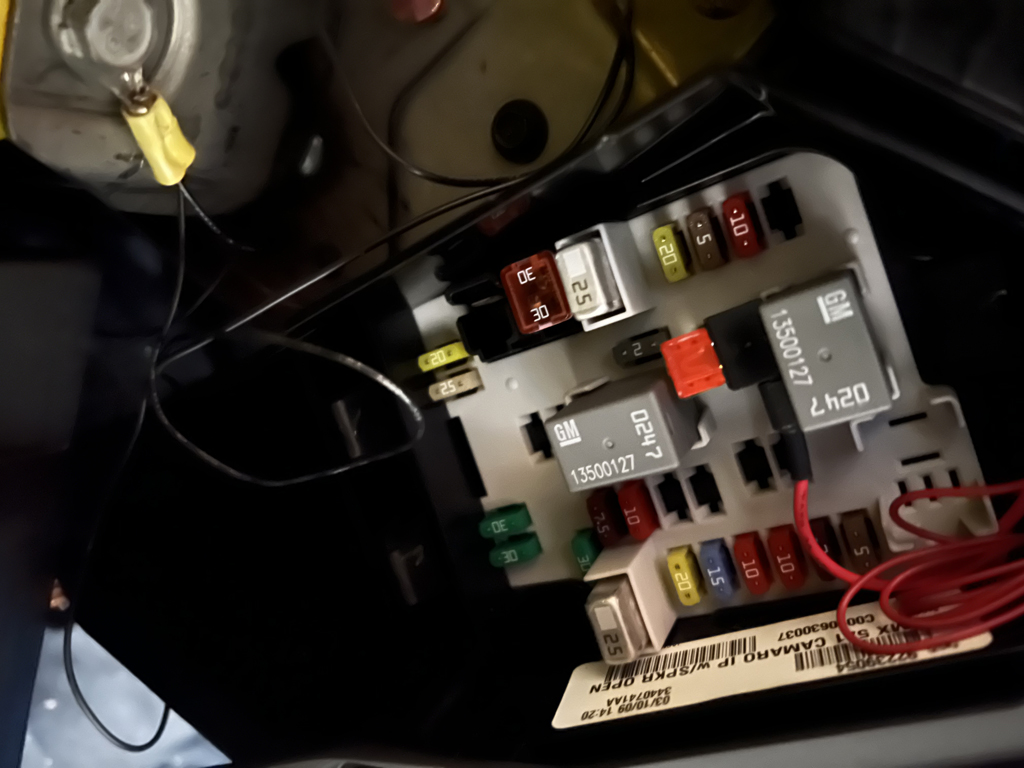

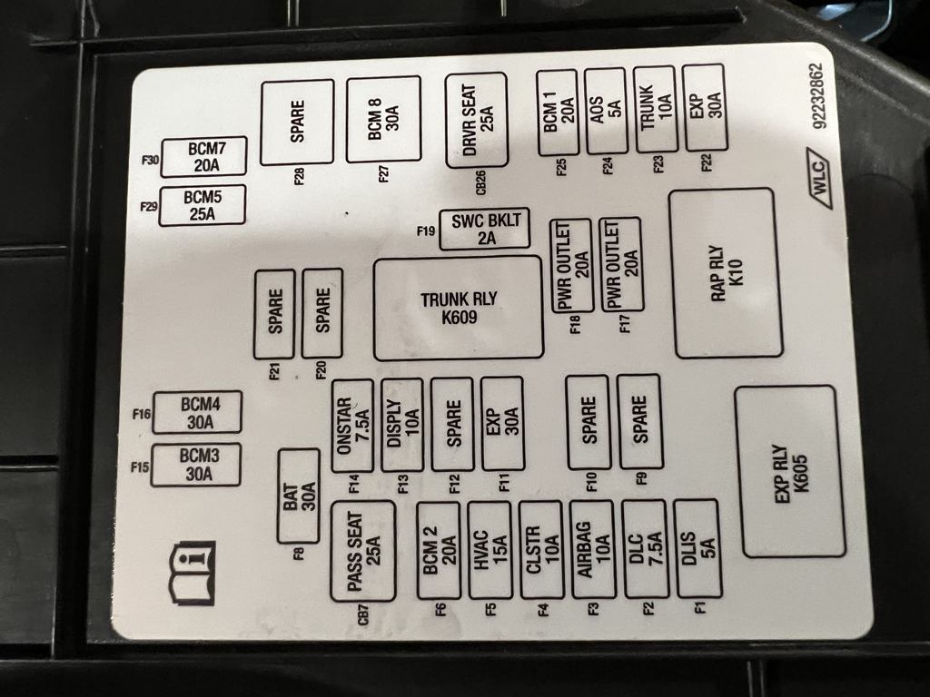

Where did you fuse in the guages if you don't mind me asking? I have the add-a-fuse links and I'm wondering where I should wire my gauges to. I also have 2 that need power.

I combined both wires into the add-a-fuse and then plugged it into the Power Outlet (F17). The gauges still have power after shutting the car off (until the door is opened). I also ran both grounds into one connector and used the bolt in the upper-left corner.

Perfect... This is exactly what I will do.
