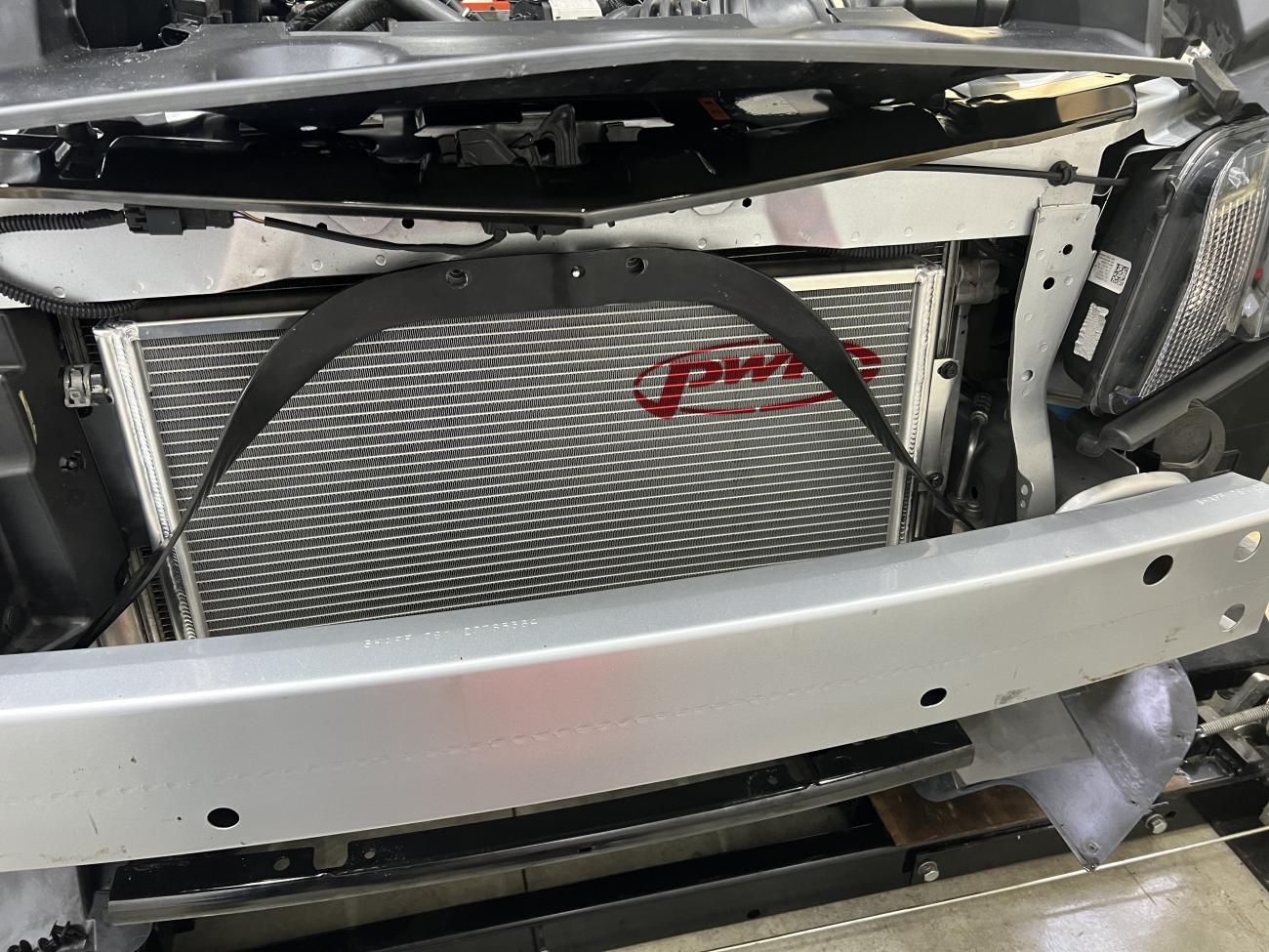

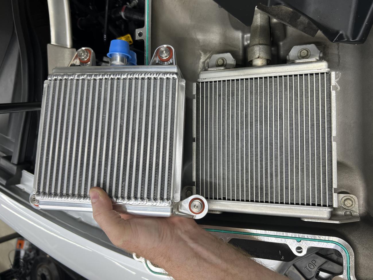

Brick: I went all out but you can send yours in to experienced tech. You don’t want a leak inside your engine after you’ve put it all back together.
You already have the pulley and I’ll get blowback from this but I’d go aftermarket harmonic balancer with larger lower pulley.
The ZL1 vert is a very nice ride. Great catch!
First pic is aftermarket brick
Second pic is aftermarket HX

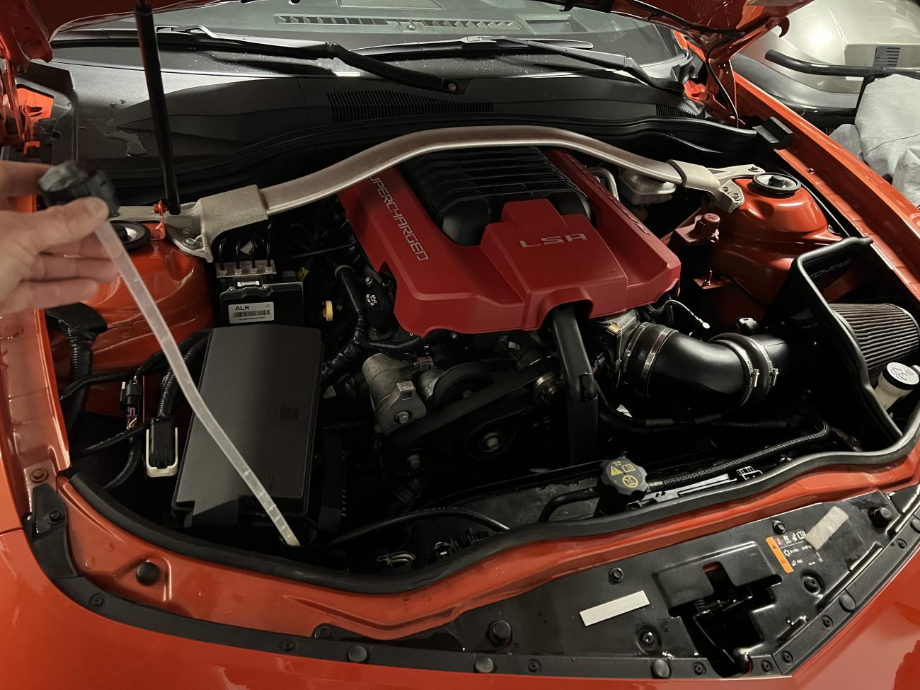

Post a pic of the engine bay. Does it have a coolant reservoir? Maybe it has the old rotofab reservoir that is known to leak.

Whoa. I just checked coolant and there is none on the stick(temps on gauges have been fine) . Now I’ll have to check the intercooler level when I have time later this week. And every other fluid that I thought the mechanic had checked. I was reading another post in this forum about how hard it is to actually fill the intercooler fluid. Looks like I’m going to learn a lot real quick, the old fashioned way.
Beachguysc is offline   Reply With Quote

Did you notice any difference in horsepower, AFR or IAT2 after you changed your oem brick to the C&R brick? Just curious looking at the photo seems like the OEM brick passes more air.

I wanted top quality factory drop ins for brick/HX. The C&R’s flows significantly better than OEM. The tubes in the bricks are much larger and much better material/quality than OEM. I installed these just prior to parking it for the winter, so I’m looking forward to running it more in a month or so. I don’t expect more hp by installation per say but benefits of a bit cooler S/C coolant system. I don’t have a tune but run high flow drop in air filter, 10% OD lower pulley for my only hp mod. This engine has mucho potential but I enjoy it how it is. I also have a Dewitt’s radiator to put in someday as well. The plastic GM cooling devices are crap and the C&R brick will hold up to any boost level thrown at it. Not that I’ll ever go there.
