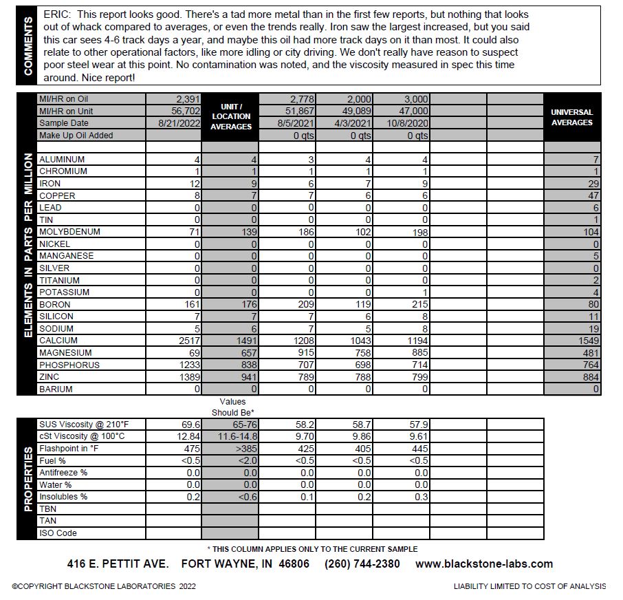

My 1LE 50k mile Blackstone oil analysis
Engine is in great shape!

why's the magnesium high, piston bored?
My old 2010 SS had 736 so I wouldn't call it high.

Nice! It's good piece of mind getting an oil test done.
I love Blackstone. After every track season, I send a sample to Blackstone to make sure she is good for another season.
Last year, I did the most track days yet on the oil.
I probably have about 5 of their mail-in kits on my work bench.

What oil are you using? Has a lot of zinc like Shell?
I'm running Mobil 10w30
I am using AMSOIL 10W40 ZROD
It does have high zinc levels!
