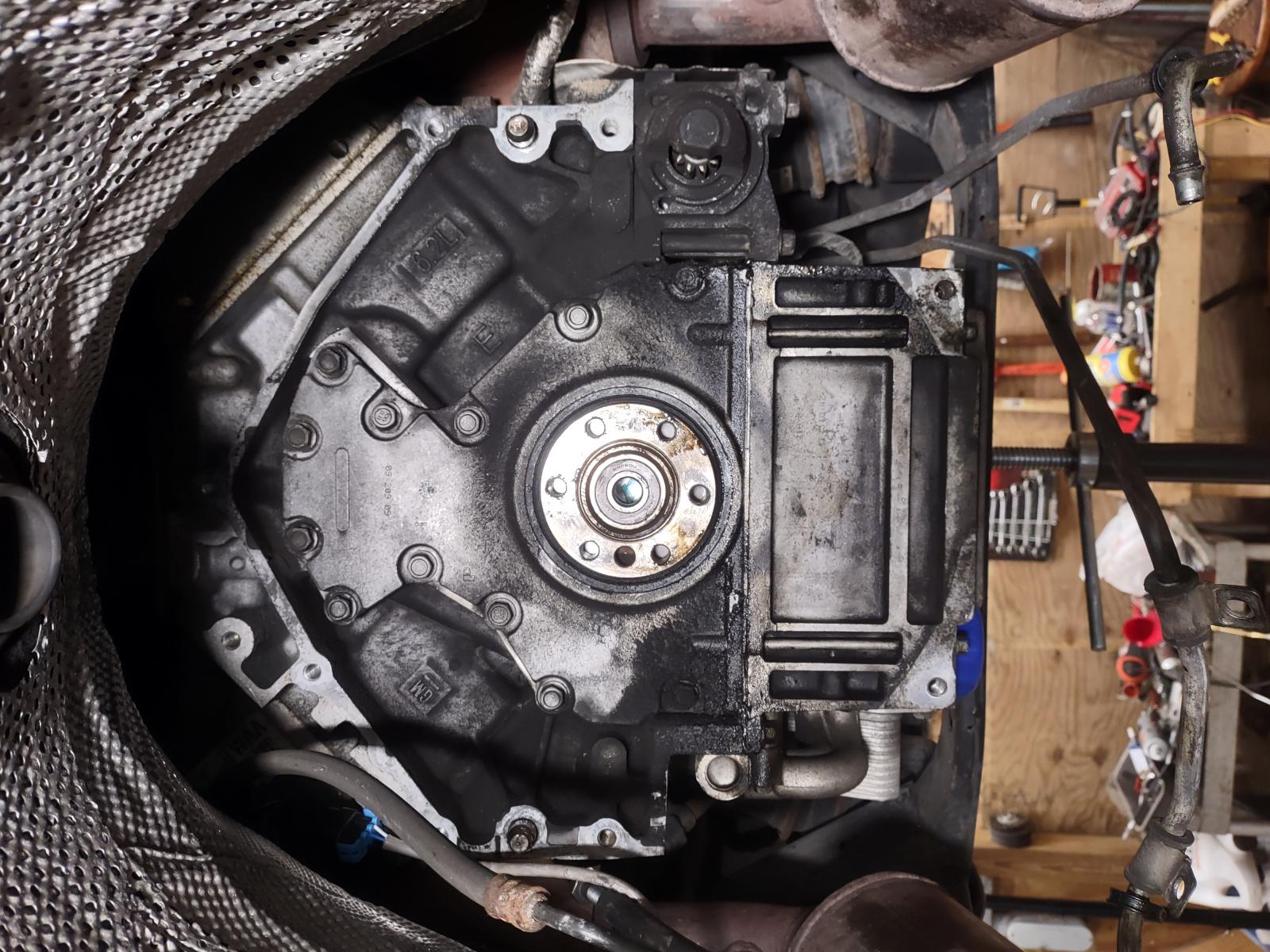

Got the new clutch in yesterday. Someone has replaced it recently, tons of life was left on the disc and PP looked new. Was also resurfacing marks on the flywheel.
Hated to put the new setup in with the old one looking perfectly fine, but come to find out I found the oil odor I've been smelling the last few months. Rear main and rear case seal were seeping pretty good. Pedal feel with the new clutch feels significantly lighter thn the old one. How is this possible if they were the same part?
Installed new GM flywheel and bolts
Z06 style clutch and PP from Tick Performance with bolts
Remote bleeder line
New GM slave with billet support bearing
Did not put the separate resivior in for the clutch. Fluid is black and needs completely flushed.
