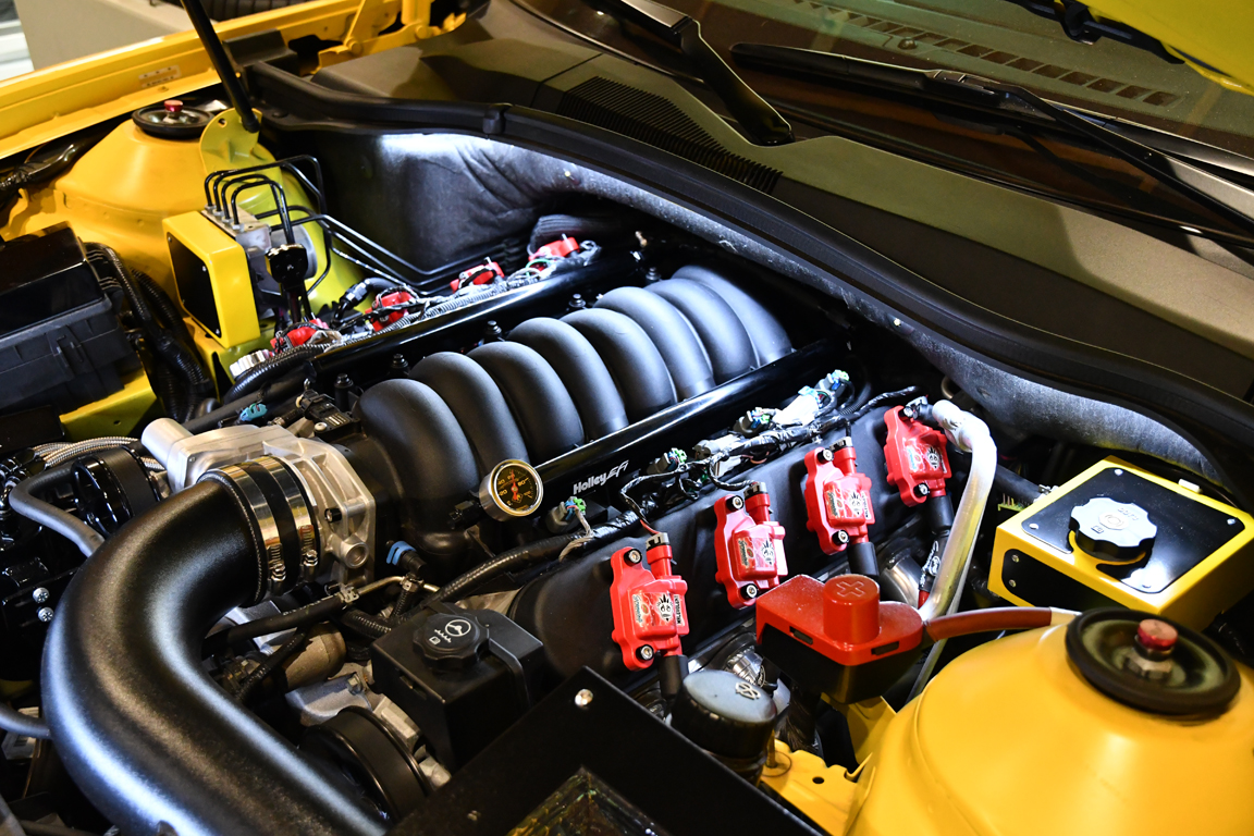

I went with Holley valve covers (black crinkle) to keep the coils in the stock location. I also have Holley EFI fuel rails and crossed the fuel line in the back.
Here's a couple angles to show how it looks.

Did you use a t in the back off the passenger rail to feed both rails. Looks great!

Thanks! Yes, I used EAR-AT925106ERL on the passenger rail. I also went with PFTE lines instead of the stainless steel lines...it was a lot easier to work with and I haven't had any fuel odors. Although it was probably overkill, I also installed EAR-AT100199ERL at the T so I could keep a Schrader valve in the system. This is the same one I used on the driver rail to mount the fuel pressure gauge.
Here's a better lit picture I took during the install.
