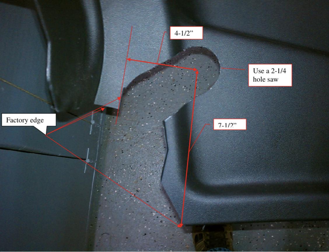

I know I’m kinda reviving an old thread but I wanted to comment about my experiences installing my rpm 6pt roll bar in my 2010 2ss.
1. This is the first time I’ve ever installed a roll bar and it’s not perfect but I think I did a great job being I had no help at all.
2. If I had to do it again I’d pay someone else to do it! At least one from rpm rollbars anyways.
3. And this is the biggest part and the main reason I am posting! The provided directions rpm rollbars provide is about useless. They are more like guidelines than actual directions. Very poorly written, kinda vague, and pictures were half useless and only somewhat helpful. They didn’t include the picture I’m including here of the rear side panels and what and where you need to cut for installation. The other picture I’m including is parts that go to the front foot mounts between them and the car. The directions made absolutely no mention of them or how they orientate or which 3 of the four holes they go to. The only way I even knew they went to the foot mounts It’s they Were in the bag of hardware labeled foot mounts. They however did do a great job of labeling hardware and what the hardware was for.
4. In the end I’m satisfied with the install my door bars are little tighter then I’d like them to be but I think it’s just easier to get in and out going over top of them luckily I’m kinda small guy if I was much bigger I’d be struggling to do that.
