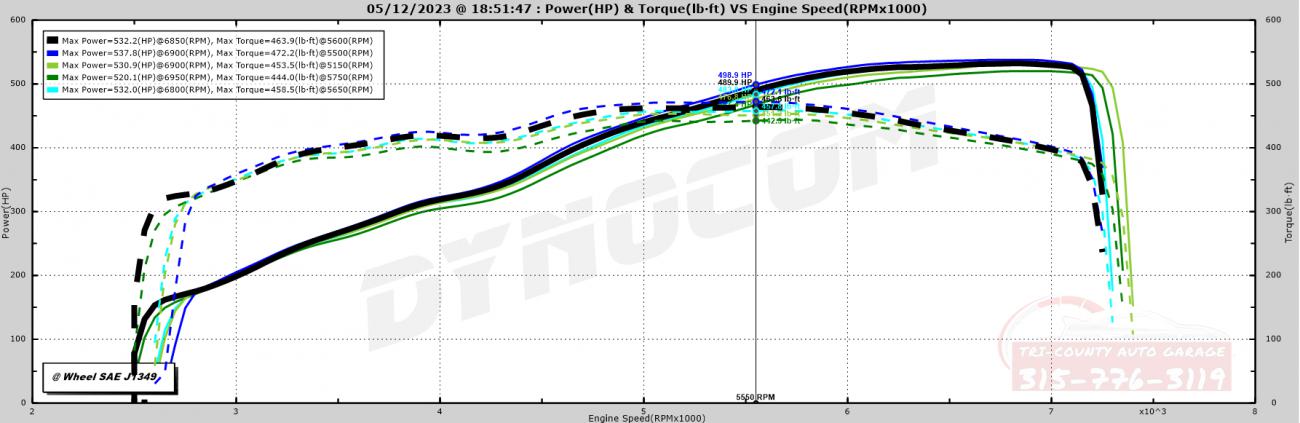

Hey guys - I thought I'd drop a little follow up in here. I was able to complete a bit of dyno testing a few days ago to get a feel for what the 9" diff is costing for horsepower. It's fairly commonly accepted that the larger hypoid offset of a 9" (which increases the tooth engagement) both results in increased strength and decreased efficiency. Most sources suggest 1-3% loss over more conventional ring and pinion setups. In general more gear ratio will consume some efficiency as well.
There is very little testing out there which actually documents the losses, so I was keen to do my own test. The combination has not changed since dyno'd at GPI, with exception that I'm running the complete Vararam, rather than just the open lid used on all our tests.
Pull #2 is the best comparison, Vararam with no filter. 538whp vs the 551whp at GPI would put the loss at 2.4%. That assumes the dynos read very close, there could be some variance there as well, and we probably have a touch more intake restriction now than when tested at GPI. As expected, the 9" is consuming a bit of power. But, for a stick shift car, getting the strength to handle the abuse, along with the aggressive starting line ratio and better rpm out the back all contributes to better performance and reliability.
For those curious on the other pulls:
#1 - Vararam with filter
#2 - Vararam no filter
#3 - open throttle body, iat reading about 25*F too high (helping keep the fueling right)
#4 - open throttle body, iat reading accurately (too rich)
#5 - turbo guard with velocity stack.
All tests were at about *84 ambient, 185* on water temp, and 200-220* oil temp. A more substantial cool down and hero pull might have made a couple more.

Some good results. That 2.4% reduction is probably well within the margin of variance in regards to two different dynos. It's quite possible you didn't lose any power but the added strength and reliability will allow you to launch a bit harder next time you're at the track. Looking forward to seeing how things work out.

Agree 100% that 2.4% could easily fall within the variance of the two dynos. I also think it's fair to say that some loss would be expected with the 9". Regardless, the added strength and reliability is welcome even at a 2-3% loss in power to the wheels. And, even with a loss in peak power, sustaining a better average power with the optimal gearing likely overcomes that loss as well. Definitely was the right move for what I'm into.
