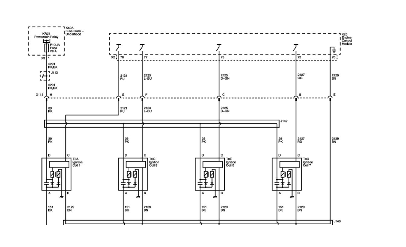

Here is a diagram for 1357. If you need any others let me know.
Thanks, this could come in handy
