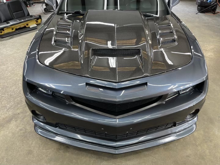

Mine was held on with pop rivets. I had to drill them out to remove it. You can see where they were in this picture.
