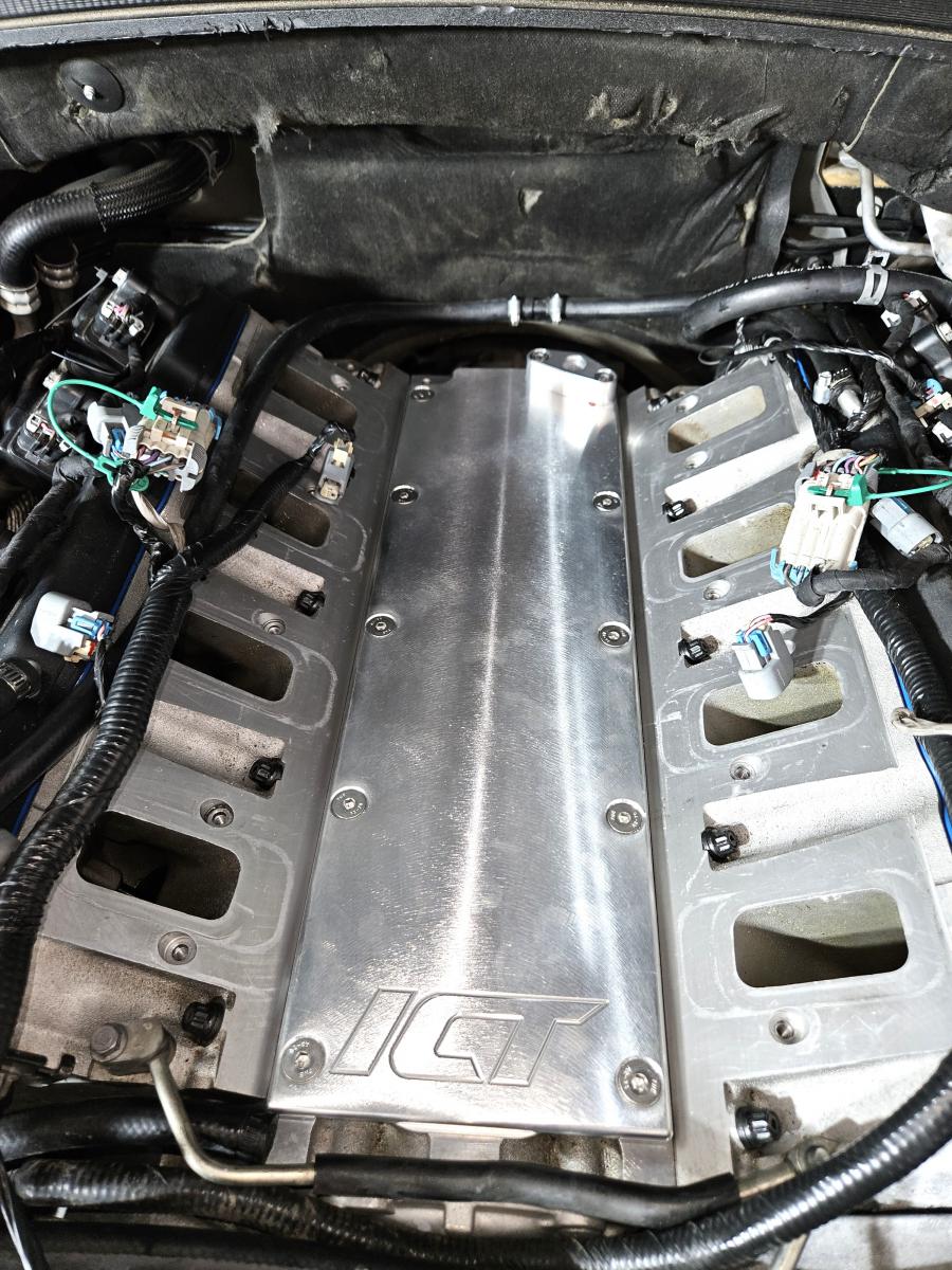

Well I still have the darn oil leak. Looks like it could be possibly coming from the valley cover again around the oil pressure sensor. So I got some engine oil dye and a blue light so we'll see how that goes. I did already purchase a billet valley cover from ICT because I believe mine is bent on the corner or somethings not right there. The only thing I don't like about it is it doesn't have the afm block off holes machined into it so for the seals. I bought the rivet gun for installing the rivets into the block to block off the oil passages for the afm crap. The only thing I'm concerned with is whether or not the rivet gun will fit under the cowl to the block allowing me to get to those two oil passages in the back. Hopefully it goes smooth.

Name:  ICT valley cover.jpg
Name:  ICT valley cover (2).jpg

Well I put the dye in the oil and then used the uv light to search for the leak. So, it did help to expose the leak but wasn't exactly where I expected it to be. It was coming from the rear of the valley cover, the oil cooler lines, and the oil cooler block off plate at the 1/8" npt port. I will tighten the oil cooler lines, teflon the 1/8" port, and I have already replaced the valley cover. I was really surprised by the quality of the ICT valley cover. The valley cover bolts are really high quality and you can really put some muscle to them to get the nice and tight. Everything was high quality, the valley cover itself, the hardware, and the oil pressure adapter. I did do the afm block off rivets too but forgot to take pictures of them. I am really bad about remembering to take pictures. The rivets went in pretty easy except the last two plugs because they are underneath the cowl. How did I do it? I cut the handles off of the rivet gun enough to get them to fit under the cowl. The very last one gave me the hardest time as the rivet gun was tilted a little and went in a little crooked but I also used thread sealant as well on each of the rivets so I'm sure it'll be fine. So I'll report back after I've driven it for a while.
Name:  ICT Valley Cover (3).jpg

Just finished everything up took it out for a drive and I think the oil leak is fixed. I'll have to drive it more to fully know. One thing I noticed was my oil pressure was up in the higher rpm range. That means I did have an internal oil leak either from the valley cover around the oil pressure sensor or from one of the afm oil passages under the valley cover.
Attachment 1135119
That plate looks really good in there.
Hello,
Glad you got the leak fixed! I see that the bottom of the ICT plate does not use a perimeter o-ring, did you have to seal it with RTV when you installed it?

Originally Posted by Vicster View Post
Hello,
Looking Great!
Oh no, I installed the lingenfelter block off rivets in the block underneath the valley cover. Is that what you where referring too?
The plate as a whole, mine from Magnuson has a perimeter gasket. I noticed that yours does not. So was wondering if you used silicone on it, to seal it to the block...
Oh I see. No I just used a regular old gasket. I looked for one like yours but couldn't find one.
