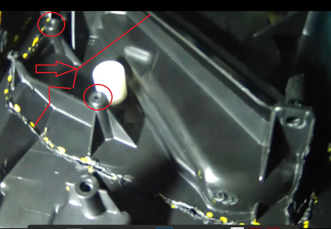

Posts: 48
I fixed mine yesterday. I cut an access panel like the 737 mechanic however instead of cutting to the left of the second bolt i cut to the right. It still has one bolt holding the panel in place and the actuator bolts both panels together. So I avoided being anywhere near the heater core and still managed to fix the ac. Took about 3 hrs to fix the door. Works great
How did you seal it up?
Can you maybe show on this picture using Paint or some program to illustrate where you cut? Thx.

Has anyone done what DP1993 did above? Cut between the two actuator mounts? If so, any issues?

For those that did this fix what are your thoughts on using a 1/4” round saw attached to a 10” flexible drill bit to make the cut?
