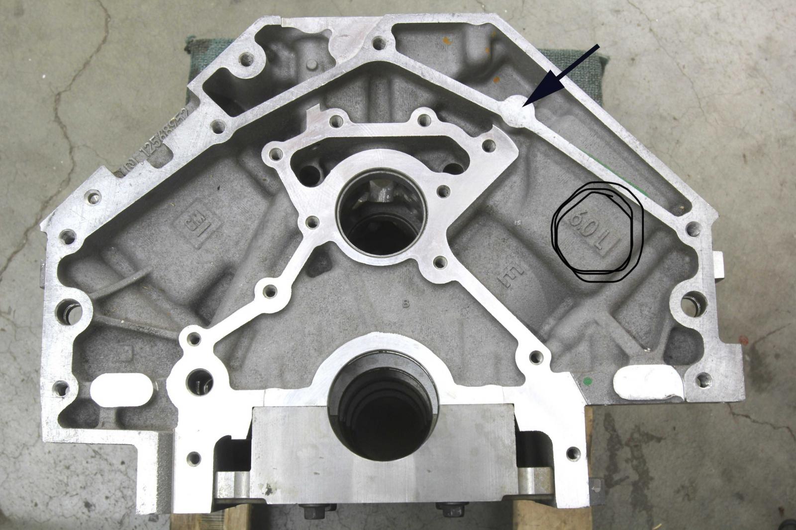

For the engine measurements, where exactly do I measure? Is it from the crankshaft flange to where that arrow is pointing to (The silver part) or where it is circled? (gray part) (and yes crankshaft flange is missing, imagine its there)
For this measurement I got: 0.178 and that’s from measuring from the silver part!

the measurement locations you used will work as long as they are accurate. I did a different approach and had the clutch system mounted to the engine when I did mine.
Visually, the end result is you want to make sure the slave has the equation measurement you are trying to achieve left at the end of its compressed travel when everything is installed. You don't want the slave fully compressed as it would push the fingers down on the pressure plate. You also don't want too high of a measurement as the slave will not travel far enough when the pedal is pushed.

I used a straight edge across the pressure plate surface and a caliper with a depth tool on it. In my case the pressure plate fingers were below the pressure plate surface so I had to measure them and adjust the calculation.
Basically the engine surface where the trans attaches to, to the pressure plate fingers is one measurement.
The trans surface that touches the engine, to the fully compressed slave is the other measurent.
How you get these can be done in many ways, the important part is to measure accurately. In my case, I always measure each point 3 times and always use the middle measurement. If the 3 measurements are too far apart I redo it to get them closer.
The reason I did it on the engine is it is actual condition and fewer measurement errors.
fz4k98 is offline   Reply With Quote
