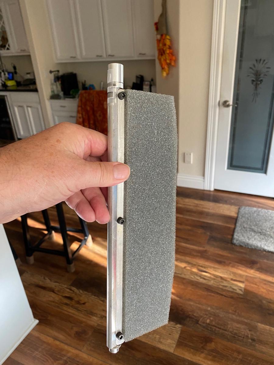

Originally Posted by camguynj View Post
You would think the foam covering would provide a better seal against the heater and evap cores than just the plastic blend door? Could you tell if the aluminum door was flat on both sides or did it have the pattern grooves on the evap core side and just the raised humps on the heater core side?
It seemed flat, unlike the plastic door with patterned grooves. I'm thinking I reversed the relative hot/cold positions of the door and the temp dial. A battery disconnect seemed to correct 'most' of the errors. It probably needs a scan tool calibrate. I'll get motivated next summer!
Another possible long-term concern is the foam dry rotting over time. Hopefully not.
Attachment 1141915
I had same thoughts about the foam sealant. I found this info from the vendor about their door and sealant https://www.blenddoorusa.com/pages/why-us
Still wonder why eom door has the groves on the evap side? Maybe for support (yea how’s that working out) just like the groves on the bottom of the intake manifold which is also hard plastic.
Well, that's good to know about the foam being synthetic. Thanks.
Attachment 1141915
I hope the foam doesn't dry rot. I had my blend door replaced at the dealership back during the summer earlier this year with the new aluminum blend door put in place. My old blend door was completely intact and looks good as new for a 2010 which has never been replaced. Had the job done along with a heater core at the same time for safety measures because my Evaporator crapped out and was leaking freon.
