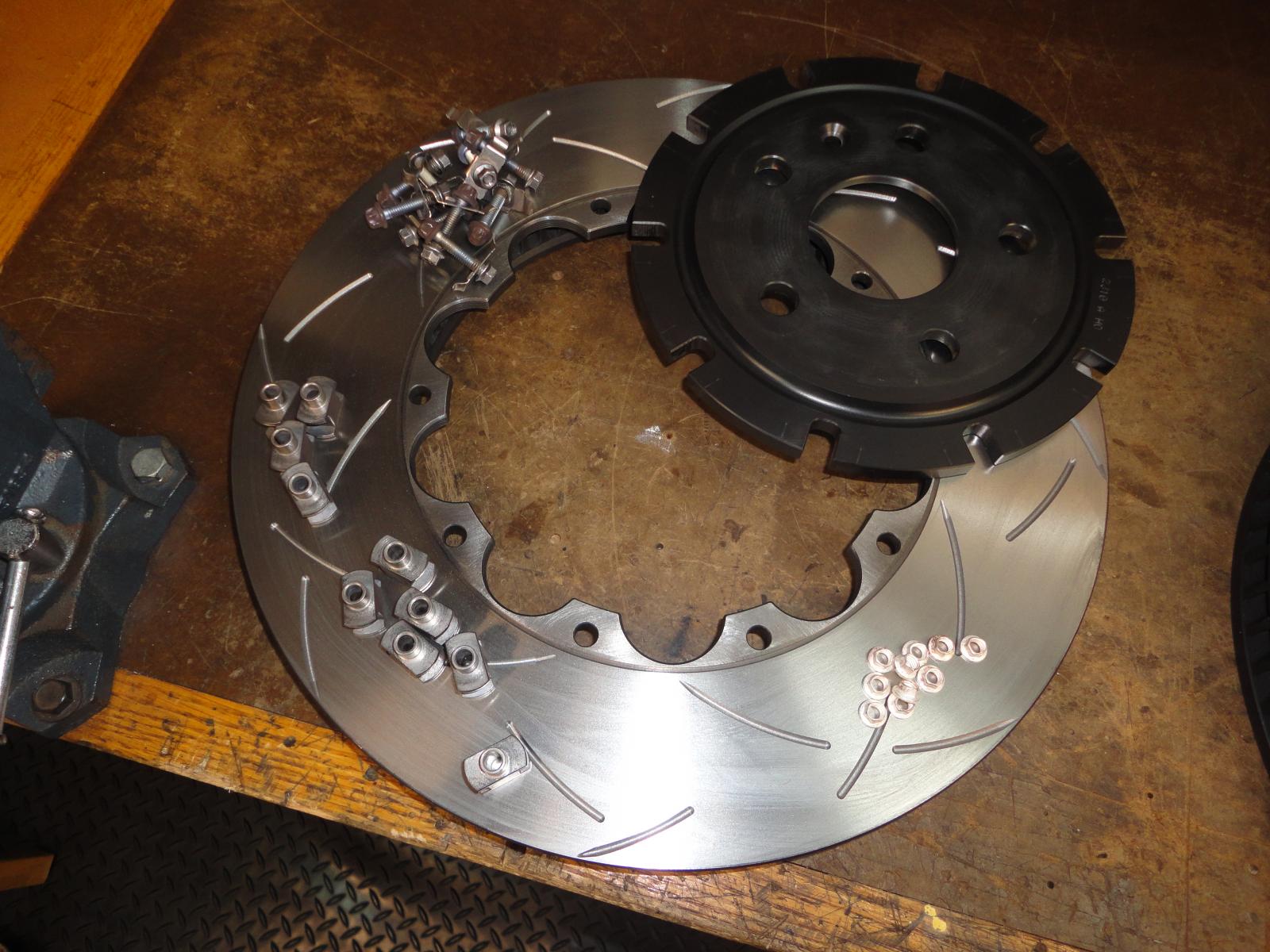

You can also run a C7 Corvette ZO6 (non CCB) rotor ring from DBA. You take the OE ZL1 hat and use it on the DBA ring.
The Gen 6 SS 1LE and Gen 5 ZL1 share the same Brembo set up EXCEPT the hat offset is different. That is why we must reuse the OE Gen5 ZL1 hat.

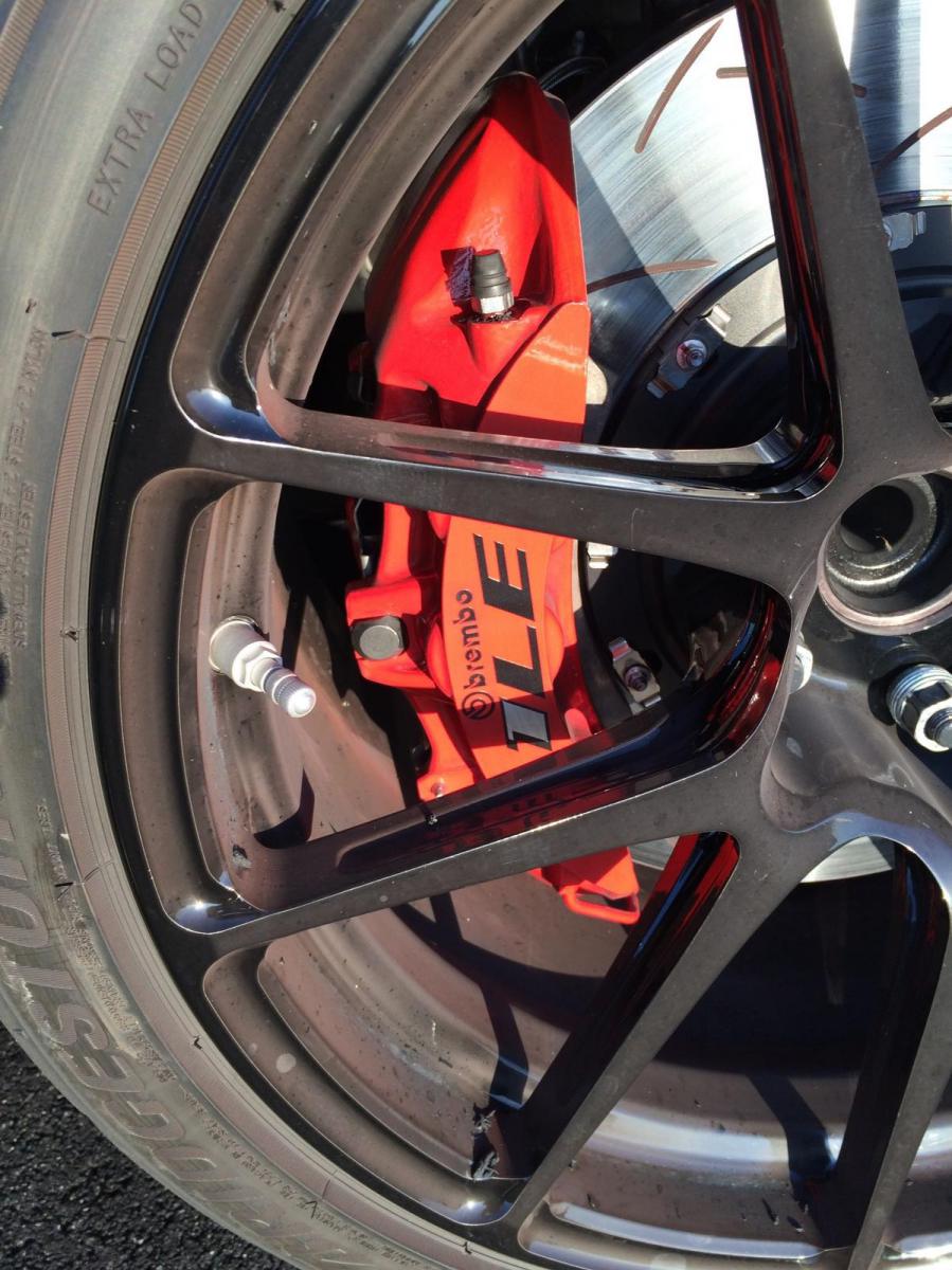

Here's my DBA's for my '14 1LE with the Brembo 6 pistons
