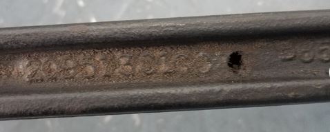

Can someone help me out I purchased the rear front control arms 23105014 and 23105015 when I received the parts they have 20951300 and 20951301 stamped on the actual part which is the numbers for the v6 and SS cars. I also ordered the front most control arms 23105018 and 23105019 and those have the actual part number stamped on the part. If someone could please let me know for certain on the rear front arms if the above is correct or not. Just want to make sure I did not get taken before the return period runs out.

Sorry for the confusion I guess they are radius rods which gm calls them front control arms. I am talking about the ones on the front of the car. On the z28 parts list here on camaro5 they are listed as control arms 23105014 and 23105015

My guess whoever you purchased the lower arms from, saw that the z28 lowers are discontinued and sent you the SS arms.

Yes that is what I think also. That is by I would like to know what is actually stamped on the real z28 arms. As I have researched and some say the arms are the same with different bushings. I don’t want to come off half cocked if these are real so that’s why I am asking.

I did find a used hub assembly from a verified Z and the part number you have is matching, you should be good!

Do you have the picture of the arm? I actually just did this mod, about a year about. They will come stamped the same as the SS arms However you just have to look at the bushing... The bushing will be painted red and/or they will have the White insert. Take pics. and I will confirm. or I have pics in my Journal build
Thank you.
I looked at your build thread and mine look like yours. I’m pretty sure they are real. Here are my pictures if you want to verify for my piece of mind.
