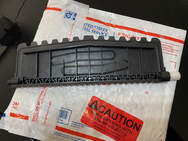

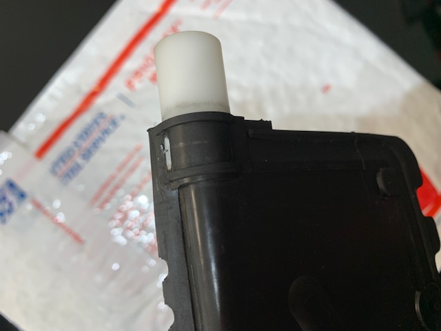

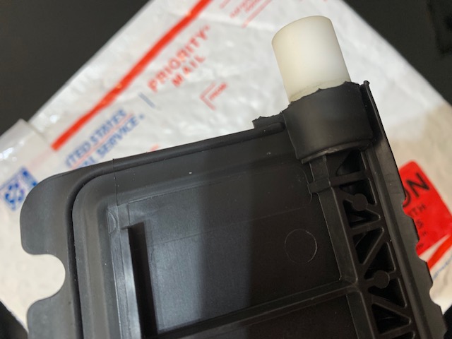

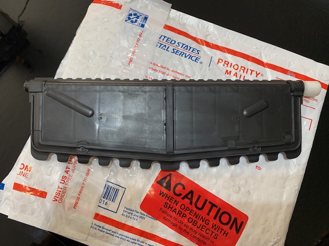

Here are some pics of my original blend door for reference with 101k miles on it before the install of the aluminum blend door....

Like you stated, doesn’t look broken.
Which makes me curious on the number of blend door failures out there... What are the percentages and how often is this happening for the unlucky ones that had to have them replaced? Is this really hyped out a little much to make people worry more and not use their AC at Max cold settings? I know I was worried so I was cautious about it.

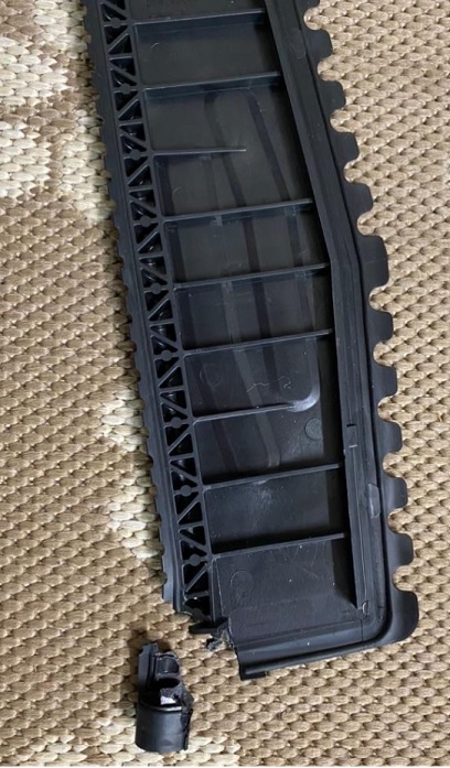

I guess my '2-piece' blend door at least left little doubt as to that being part of my problem. Mine still blows a little warmer on the pass side. My tech told me that the system, "favors the driver's side." Anyone every heard that one?
Never heard of that. To me, if anything it would be the opposite.
Attachment 1150033
Wow. Did you install the new aluminum blend door yourself by cutting out the side of the box or did you have a shop install it?
Against my better judgment and comfort zone, I couldn't bring myself to pay the crazy labor. Put it in myself with the now classic, "hack." But you won't hear me talk about what a piece of cake it was. Though I took many breaks, it was 3 days!
Pretty happy that part works according to the Snap-On scan tool.
