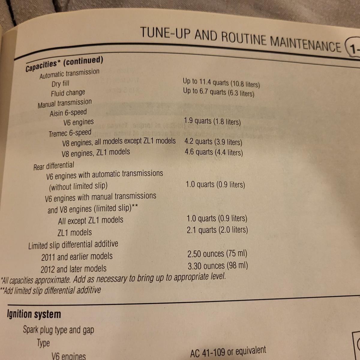

Here's 3 outta 4 from the Chilton manual. For brake fluid 2 (maybe 3) 12oz bottles should suffice if you're doing a flush. If just a quick bleed than just 1 should be ok. Your car does have the big Brembo calipers so you may want wait for someone to chime in that has flushed in DOT 4 for track use, they'd have an exact amount they used.

does the tr6060 capacity spec include the cooler and lines (essentially "dry") or just a drain and fill? going to clear out the cooler too next change so curious how much i should add afterwards, especially since its basically impossible to get even a gallon into the case at a time from past experience.
That half liter difference between the SS and Zl1 TR6060s is the cooler lines and cooler. When I put diff coolers on my cars they took approximately 4.5 quarts to refill with the cooler in place.
so the capacity spec DOES include the lines and cooler? so if i were to drain the transmission, lines and cooler it would take the full 4.whatever quarts to fill everything back up and be at the correct level in the mt case?
