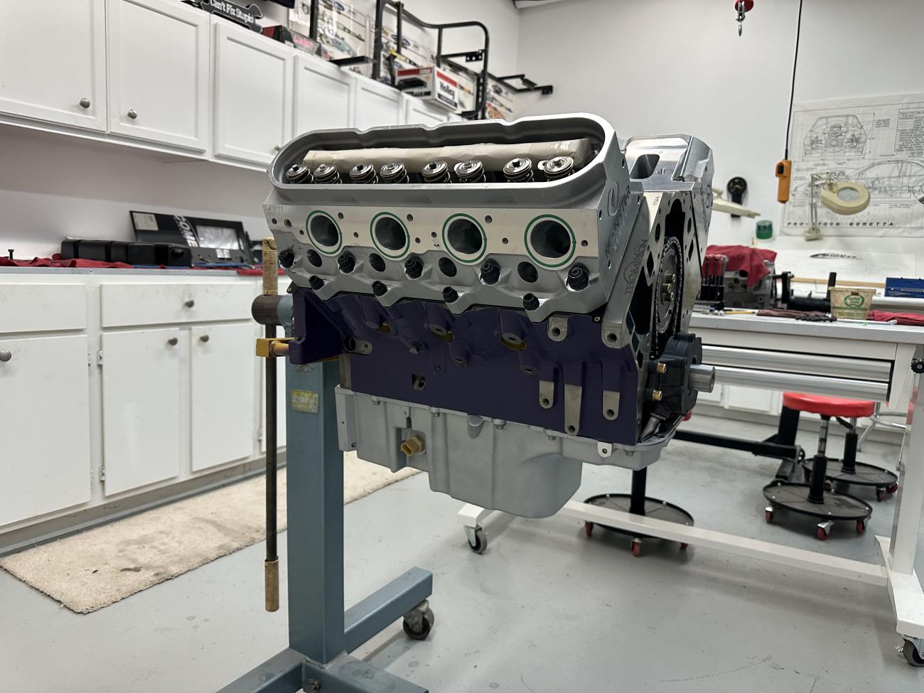

Well guys it’s been a long time. Life got in the way and the new power plant for the Camaro took a back seat for a while but I’m now back in the thick of things. I’m waiting on my tuner to get back with me but they are so busy so thought I would post on here. I have assembled the top end and am now looking for suggestion on my intake and injector choices. I have a factory ls3 manifold with stock injectors sitting in the shop but let’s get everyone spun up on where I’m at and why.
I don’t have the coin currently for the turbos so I’m looking into what makes the most sense and not waste money. I’m currently waiting on the factor GM ls3 rockers with CHE trunion upgrade from tsp and already have my pushrods. Yes I already measured for proper length with a factory set of rockers. With that said. I don’t know whether or not to use the factory manifold or spend the money on a BTR. The car will stay NA for a bit while breaking in the engine and new clutch which I’m thinking of ordering the monster triple disc. Any other inputs there?
Injector wise I don’t want to waste money so was wondering should I purchase the injector size I need or my end horsepower goal with the turbos along with the BTR manifold and a aftermarket throttle body? Or just use the factory stuff for now? I don’t know that the stock injectors are rated for e85 so I was trying to keep from spending money on injectors twice.
Thanks for the help in advance and I’ll try and post some pics.
57jettruck is offline   Reply With Quote

Using E85 turbo injectors with gasoline NA could be tricky. You might get by with it with good injectors with full injector data in GM format. I wouldn’t do anything about injectors without consulting your tuner since he is the one that will have to make them work. One of the most common problems on HPT forum is to big an injector and can’t get them to hot/cold start or trouble with idle.

If you are putting in a turbo fuel system now and have already done the e85 swap then new injectors are a must. Luckily they can be had for a decent price if you don’t wanna plop down the cash for a big set.
Are you set on the btr intake? I love the look, but haven’t seen anything good about it, especially N/A. I didn’t read through here and don’t know your goals, but the factory intake is hard to beat on the street. You can pickup 10-20 peak hp with others, but that’s at a sacrifice of low end power. Not many intakes average better numbers over the stocker.

Originally Posted by 57jettruck View Post
I have to comment to get thread notifications and since I'm here just want to say I love the shop. Looks like an engine assembly lab! Nice setup.

Thanks for all the input guys, I’ve been leaning towards reusing the stock manifold just bc I don’t see really large gains or other plus sides to an aftermarket intake that will fit under the stock hood and retain the wipers. Maybe down the road at some point I will spend the money on a really nice intake. So with staying with the stock intake I’m just waiting to talk to my tuner on injector size as I would stay NA until after break in and turbo parts to be in route. I was looking into FIC clinic 1650 or 2150 for my end power goals as I already have and will be installing the AGP triple pump with flex fuel sensor rated for e85. Of course waiting to hear from my tuner to see if he wants me to run a smaller size while NA. I’m building everything overkill as I don’t want to lean on anything to its max I want this combo to live happily.
How do yall feel about the monster triple disc clutch?
