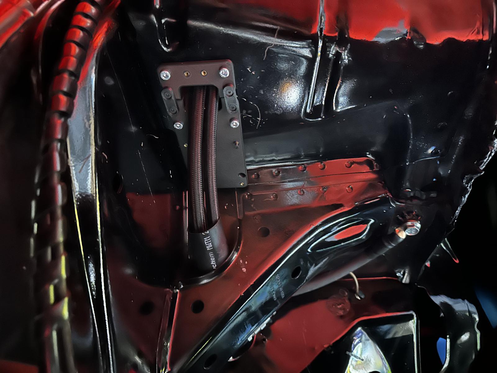

Fuel system in finished except for terminating the pump trigger wires. I won't do that until I'm ready to prime the system.
Fuel Filter with stock FPS mounted on outside of frame rail. Flex Fuel sensor is mounted just in front of the tank. Fuel lines run into the wheel well and up through the cabin filter. From there into the cowl and exits behind the intake. Fuel pressure regulator mounted on the timing cover and hard lined return to the firewall. Everything is PTFE. I am designing a cover for the lines in the wheel well, Still a work in progress.

great work continues! I have contemplated moving my fuel line that way as well to get it away from the exhaust.

I’m pretty happy with how it laid out. I’m not scared to cut a little metal so it allowed me to do it the way I did.
