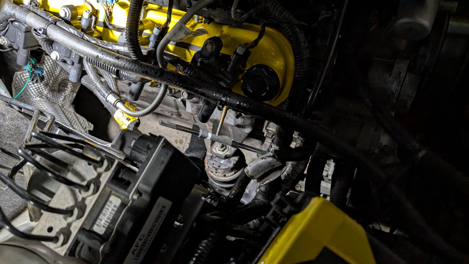

Oh also while doing the oil change from first track day I noticed some oil was leaking from my aftermarket dipstick tube, I kinda hated it anyways but kept it to keep those LS7 covers, decided that was enough so bought some Holley valve covers, got them powder coated and threw OEM dipstick tube back, while at it tried my hand at vinyl cutting by hand, results wasn't great because eive never done it before, especially the strips but from distance and covered by the coil packs it looks fine.

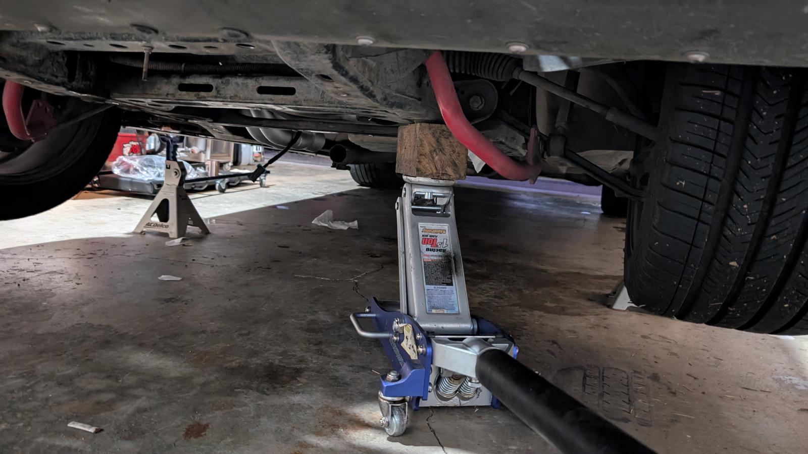

Took last week off for Christmas and was looking forward to relaxing for a week, until I made the same mistake I make every year at this time and decided it was the only chance I'd get to work on car for while (last year was cradle bushing, the one before that was removing dash for hud). So I decided to do the long tube headers and in process fix up the threads on the heads, put in the ARP studs and install the wideband sensors and gauge.
Started by removing my old shortie headers, was able to drop the one on passenger side directly under the car, driver side one had to seperate and remove in two because of the steering rack, then went in and took the ol threading tool to the heads, it did remove a fair bit of material so I think it's now got threads in threads but it's better then it was, just have to be careful with the torque on passenger side so I don't spin them
Then I proceeded with the headers, I had them ceramic coated so I tried not to scratch them, laid down some wrapping material and everything, it went in smooth on passenger side but driver's was a nightmare, spent probably an hour or two struggling but it kept getting caught on motor mount, steering rack and a little square poking out of Bell housing, I ended up doing it by raising the car nearly 2-3 feet up was just few inches shy and ended up using a 4x4 post chunk to get it final bit over (fun fact, same chunk that dropped the car on me last year but I was out of options, also maxed out the jack stands and as you can see in pic below even that wasn't enough)

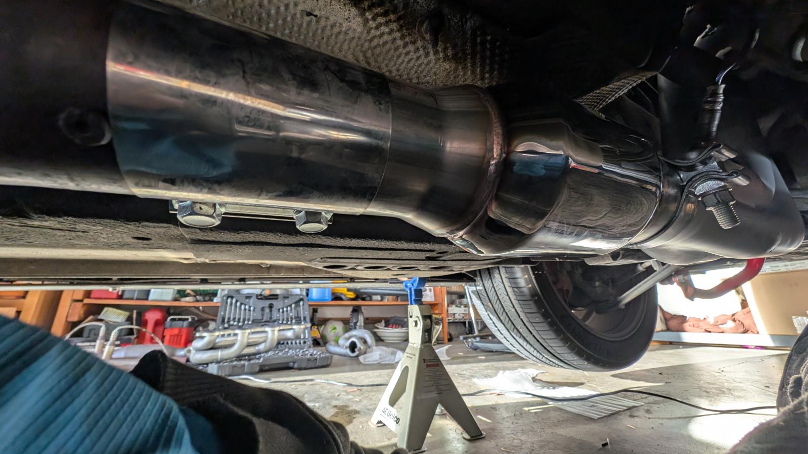

With that done I called it a day and figured I'd do the cats next day and call it early because Christmas Eve, what I didn't realize is that the cats are almost flush fit with exhaust so while I was able to shimmy the tubes enough to mount cats on collectors the cats to exhaust was a different story, I originally intended to use stock clamps because I know they work, but because of the stupid locating screw and bump I couldn't slide them all the way down the pipe on resonator side and they were too long to slide on the cat side, so I settled on what I had which is a set of ebay special Chinese ones I could just wrap around the pipe, they almost certainly are leaking but it's something
