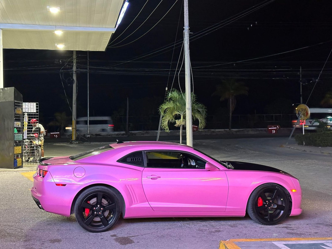

Photo of the height my car had when coilovers where installed:

Now THAT'San interesting color combo!! Is the car wrapped? Cowl hood too?? Looks pretty cool. Good luck with your issue. As SS said, sometimes you can go too low and throw off the diff and axle geometry too much and cause issues.
