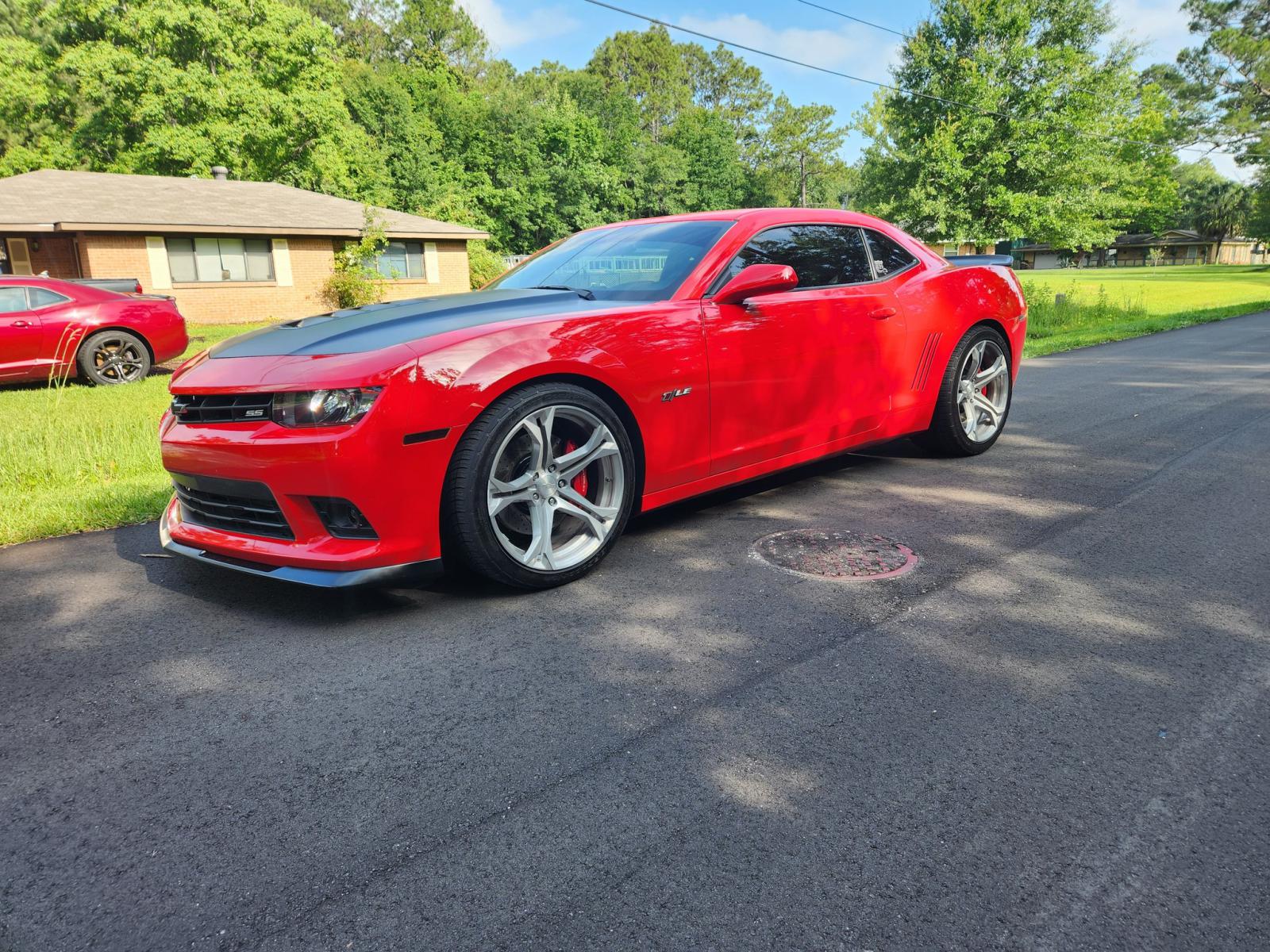

Old Yesterday, 03:44 PM   #23
FASTFATBOY
Drives: 2013 ZL1
Join Date: Nov 2018
Location: Mobile Al
Posts: 524
UPDATED
2015 1SS 1LE, Magnuson 2300 Heartbeat and headers. 550rwhp STD, 535 SAE.
