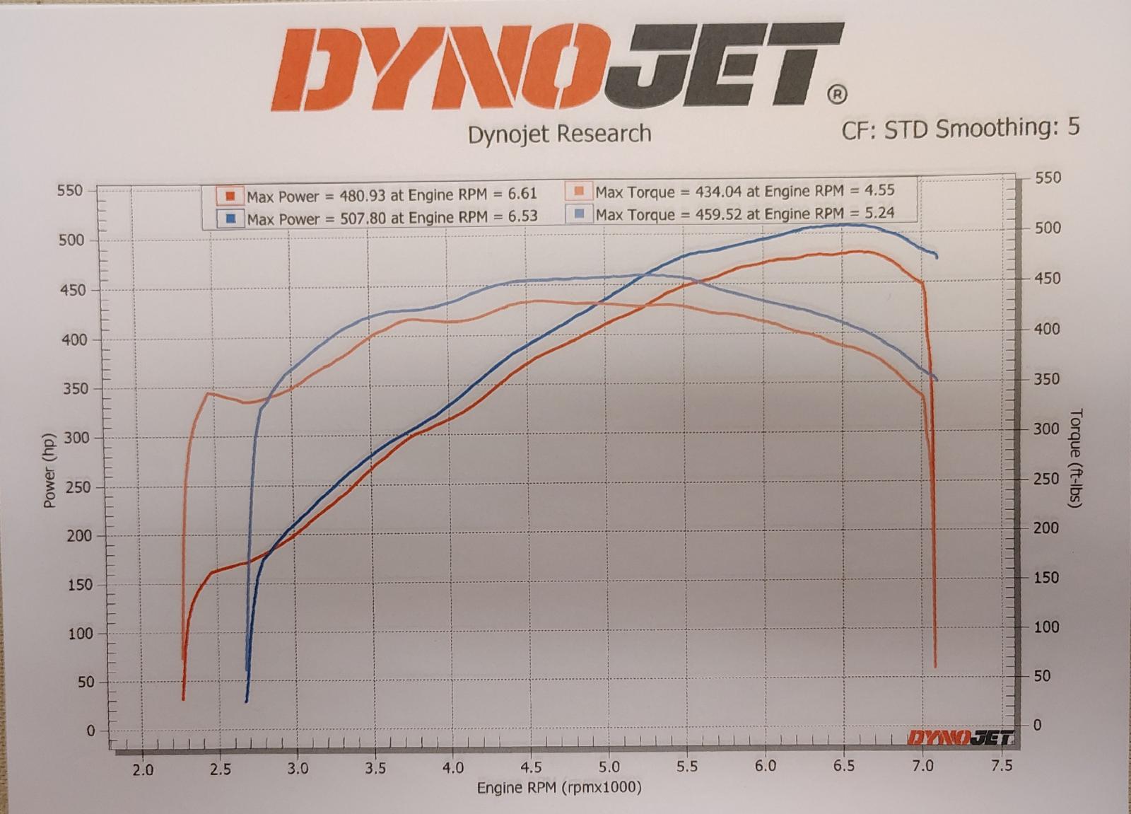

Posts: 8,091
Got the 11° heads from Wilkes Performanc put on during the new year holiday. Went back to Gen3 Performance and Dyno to get the tune redone.

Old 01-25-2025, 08:29 AM   #115
Joe.G
Joe.G's Avatar
Drives: 2014 2SS/RS 6SP Ashen Grey
Join Date: Aug 2021
Location: NY
Posts: 1,768
Looks good congrats on the gains.

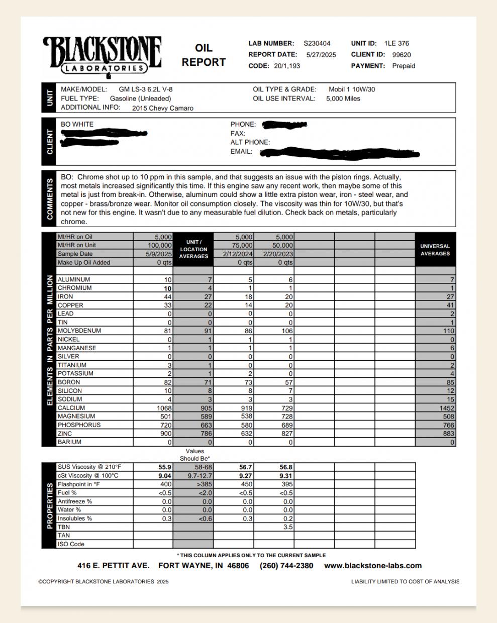

Old 05-28-2025, 05:14 PM   #118
Bo White
Bo White's Avatar
Drives: 2015 Summit White 2SS 1LE
Join Date: Feb 2012
Location: Vance Alabama
Posts: 8,091
I didn't tell them that I had just did a new top end(heads and cam) with time on 2 dynos so this makes sense. My 125k test will tell the tale.

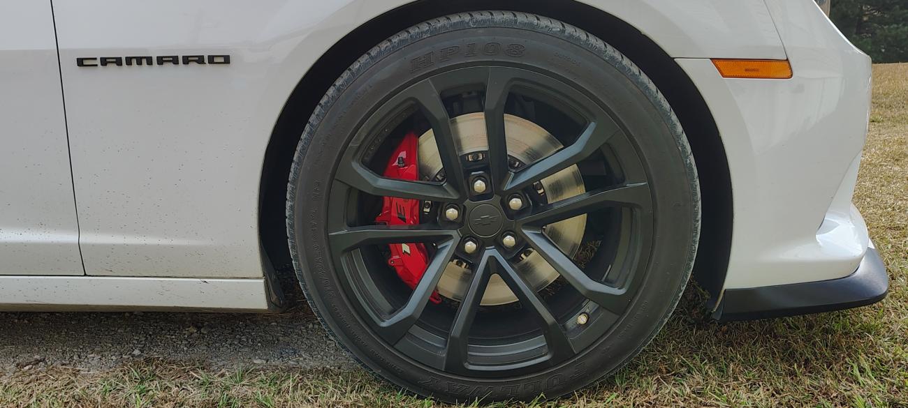

Posts: 8,091
Installed 6th Gen Camaro 1LE front calipers, 5th Gen Camaro ZL1 rotors and hoses.
Bolted right up.
I didn't want 5th Gen ZL1 calipers because 6th Gen 1LE calipers are red and have 1LE on them 😜

Old 09-18-2025, 10:51 PM   #124
Joe.G
Joe.G's Avatar
Join Date: Aug 2021
Location: NY
Posts: 1,768
Looks good.

Old 09-19-2025, 06:41 AM   #125
camguynj
camguynj's Avatar
Drives: '13 SS/RS LS3 BRM Cammed NPP
Join Date: Jan 2013
Location: NJ
Posts: 3,856
Sweet!
