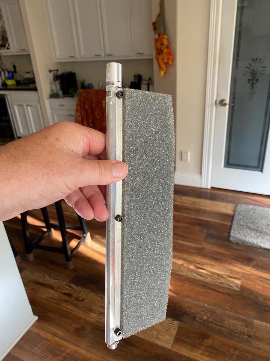

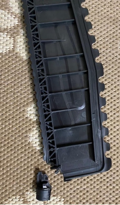

My 2015 ended up going at 8 years and low miles. (2023 @ like 40K at the time.) I spent 2.5 days on my back with the seat out. I went with the aluminum door. Hope to NEVER have to worry again. You guys with it 'stuck' in one position are lucky. Mine was busted in two and the door was lying on the vent box floor.
Name:  broke blend door.jpg
Attachment 1170564
Attachment 1170565
Wish I saw that when I did my LT to SS conversion, thats awesome.
