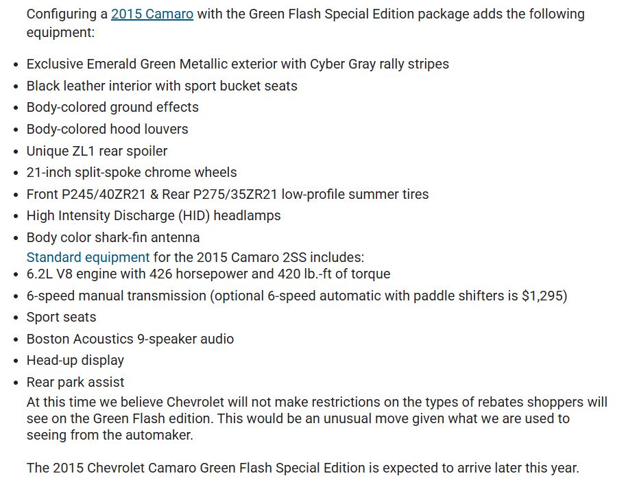

I'm the proud new owner of a 2015 2SS Green Flash.
I'm looking to save some ACDelco TDS manuals, but I'm running into a few discrepancies.
From what I understand, the Green Flash edition is not just a 2SS, but has some features from the 1LE package. Looking at the TDS options, they lump RS, LT, and SS together, and then Z28 and ZL1. Nothing seems to have options or choices for the 1LE package.
Which ones are going to be more accurate for what I need?
Thanks everyone. I'm stoked to finally be a Camaro owner, but now I'm feeling like I have a lot to learn.

Since service manuals don't typically do part numbers, I don't think anything from a 1LE would show up any different than an SS as far as what the service manual shows. It would just be different parts bolted in place.

It appears a few had the 1LE option? Look in the trunk under the carpet and there will be a white sticker, see if it has "1LE" on it. I'd be surprised if it did. Go here- https://www.camaro5.com/forums/showthread.php?t=422717
You can look up parts by VIN on any GM parts website.
If you really want a legit build sheet with option codes go to CompNine https://www.compnine.com/vid.php
