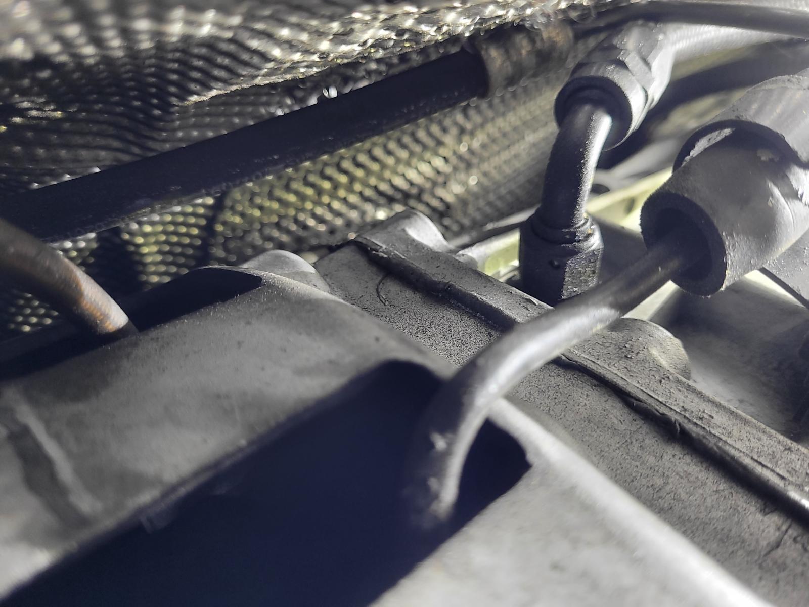

Also, do you still have the setup or any photos of it installed? This would really help out a lot of folks, since there’s not much info, and so much conflicting and/or incorrect info. People who mod their cars will definitely love to do this. I wanted to upgrade my radiator to an aftermarket aluminum one, but idk how reliable they are. I see Mishimoto and it’s pretty pricey and I could find a similar aftermarket brand for cheaper.
I just installed a custom Champion three row that moved the location of the top hose and cleaned up my turbo install. It was $400 and the fittings worked well on it too.
Here is a pic of the fitting in the radiator and in the driver's side of the trans.
