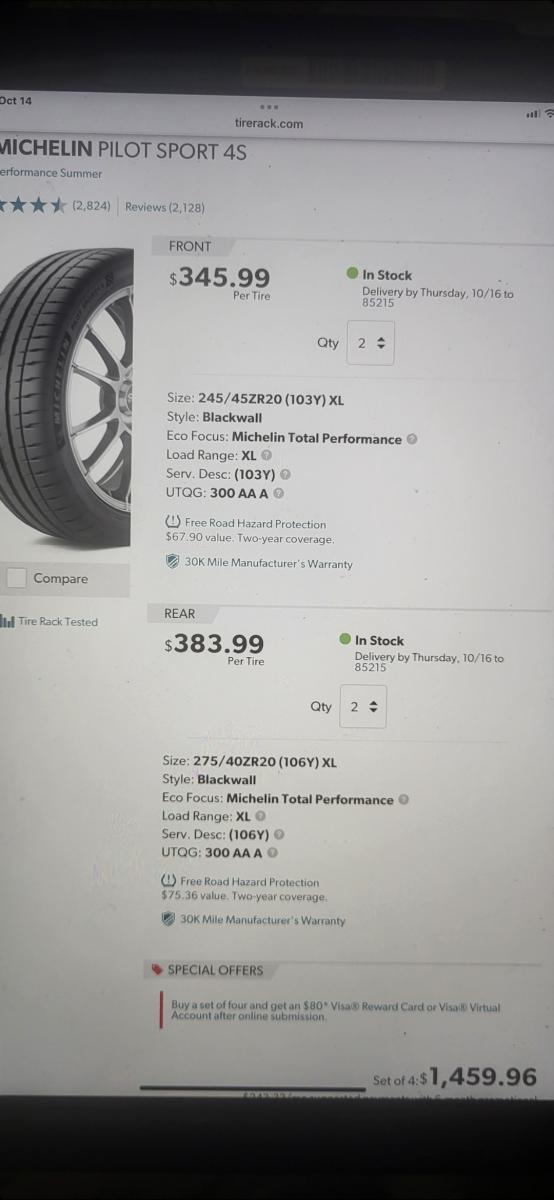

I am looking at getting an entry-level autocross for my 2012 Camaro LT.
I was originally looking at the Goodyear Eagle F1 Supercar, but I'm not really wanting to spend $1,600+ on tires just yet.
Would something like the Nitto NT555 G2 or BFG G-force Phenom T/A be a good start, or should I suck it up and spend the extra money for higher-end tires?
(Current tires are a mix of two different brands, whatever was on it when I bought it)
(The LT Camaro is in the street division. Tire width must remain the same.)
(Front 245/45/20 rear 275/40/20)

Just a quick search, the Advans have your front tires. The rears, you should be able to squeeze into the 285/35-20. The recommended wheel width is 8-9 inches for that size. You would just have to look at your classes. I know my 1LE was in CamC for autocross

A quick question: How experienced at Auto X are you? As you mentioned "entry level" I'm assuming you're just getting started. Maybe run what you have for the first events and see if this is something you want to fully invest in OR you decide to only do a few races a year just for fun. I dabbled in Auto X with my Z/28 a while back and my Michelin Pilot 4S tires were excellent for my ability. A bit pricey but they are a good dual purpose tire.
*Note* I just looked at tire rack and they call out for a 245/45/20 for your front. Plenty of 300 treadwear tires in your sizes.

I'm still in street division. so I can't change the tire widths without moving up into the bigger leagues. It does love to understeer. So I guess I could slap some better/grippier tires on the front as a start

I've done two. And I like it. So I've already started changing some things. Another more experienced driver recommended the same about staying with whatever I have until I get better as a driver. So I didn't start relying too much on the tire and not skill. But I was going to see if there was a halfway decent tire better than 'whatever is on it's. As a good starting point
