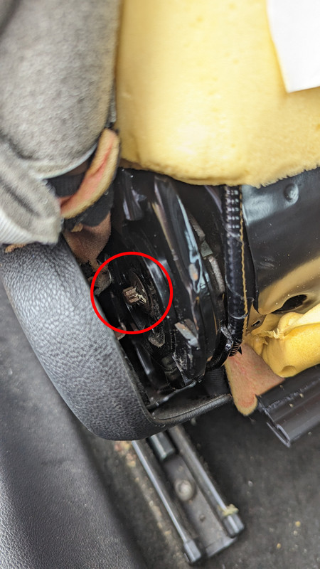

Want to thank you for your post as it helped me out. However I didn't bother with the pressing down of the metal tab. I just took pliers to the screw/bolt circled in red and moved it backwards as I pressed the seat switch recline back. Motor now moves the seat back forward and backwards. Now I just need to fix the other issue of why it's not heating up any more.

I have a 2012 Camaro LS and honestly I though the dealer replaced the car seat but I see some Camaro seat switched have one toggle on the driver's side instead of two. Anyway recently my seat got stuck in the recliner position and I cannot figure out a way to get it back up. I recently changed the switch hoping that would work but its still stuck. Anyone has any tips?
