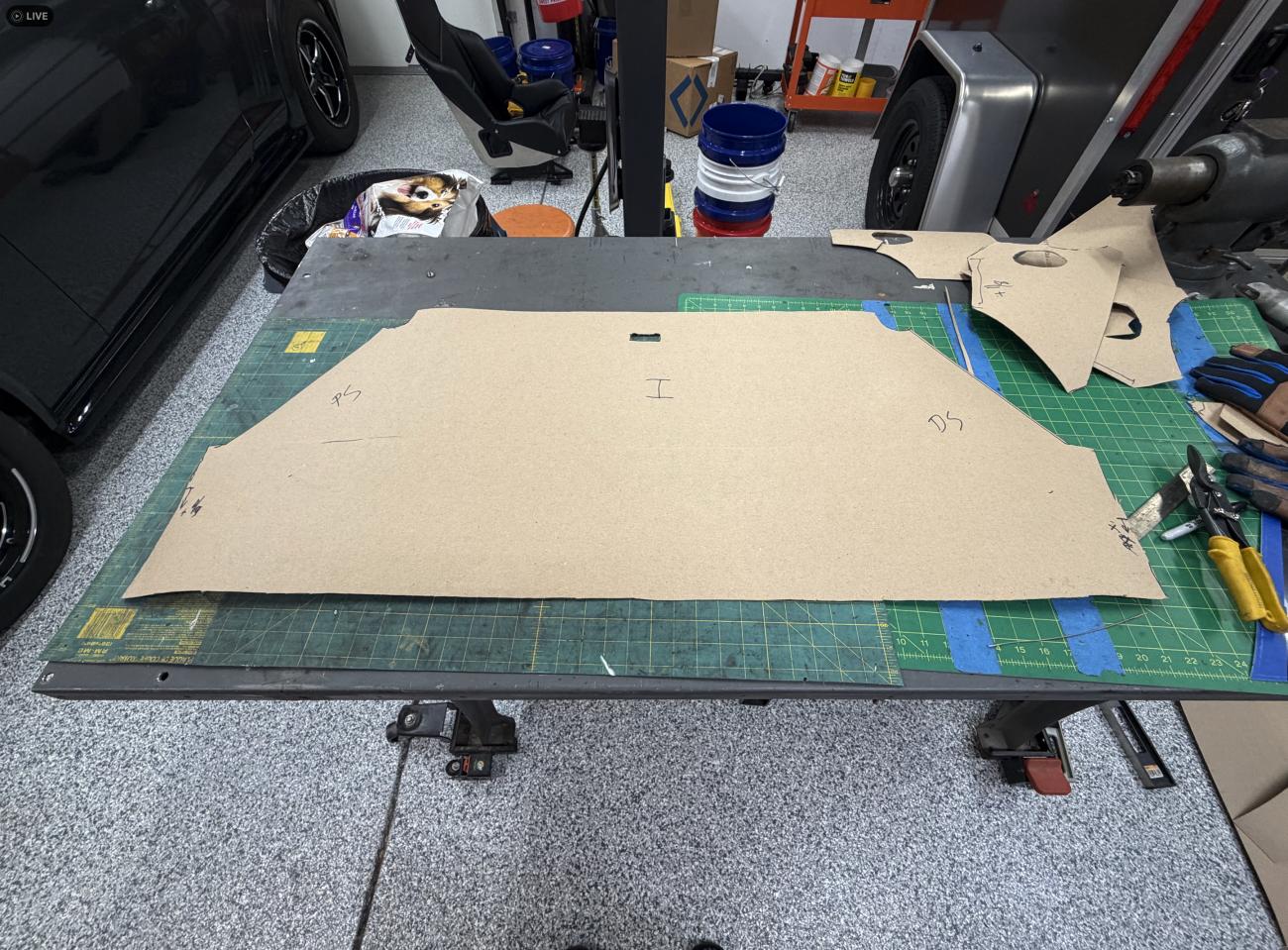

Next up in getting ready for Sick Week is creating a bulkhead and sealing the trunk area off from the cabin. This is a NHRA requirement since I have methanol tank in the trunk and technically the battery has been relocated. Calls for a minimum .032 aluminum or ..024 steel. My local steel supplier had .040 aluminum so I used that.
It's been a very long time since doing any sheet metal work and haven't done much of it. So there's that.. lol
So got started by digging out my CAD stuff to help aid in designing this.
Just for clarification, CAD is Cardboard Assisted Design..
Name:  Screenshot 2026-01-25 at 5.39.52 AM.jpg

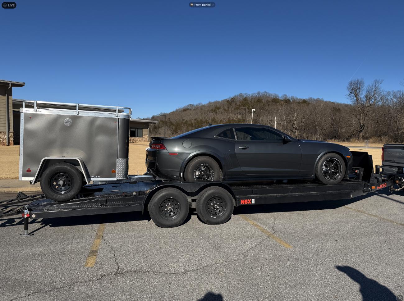

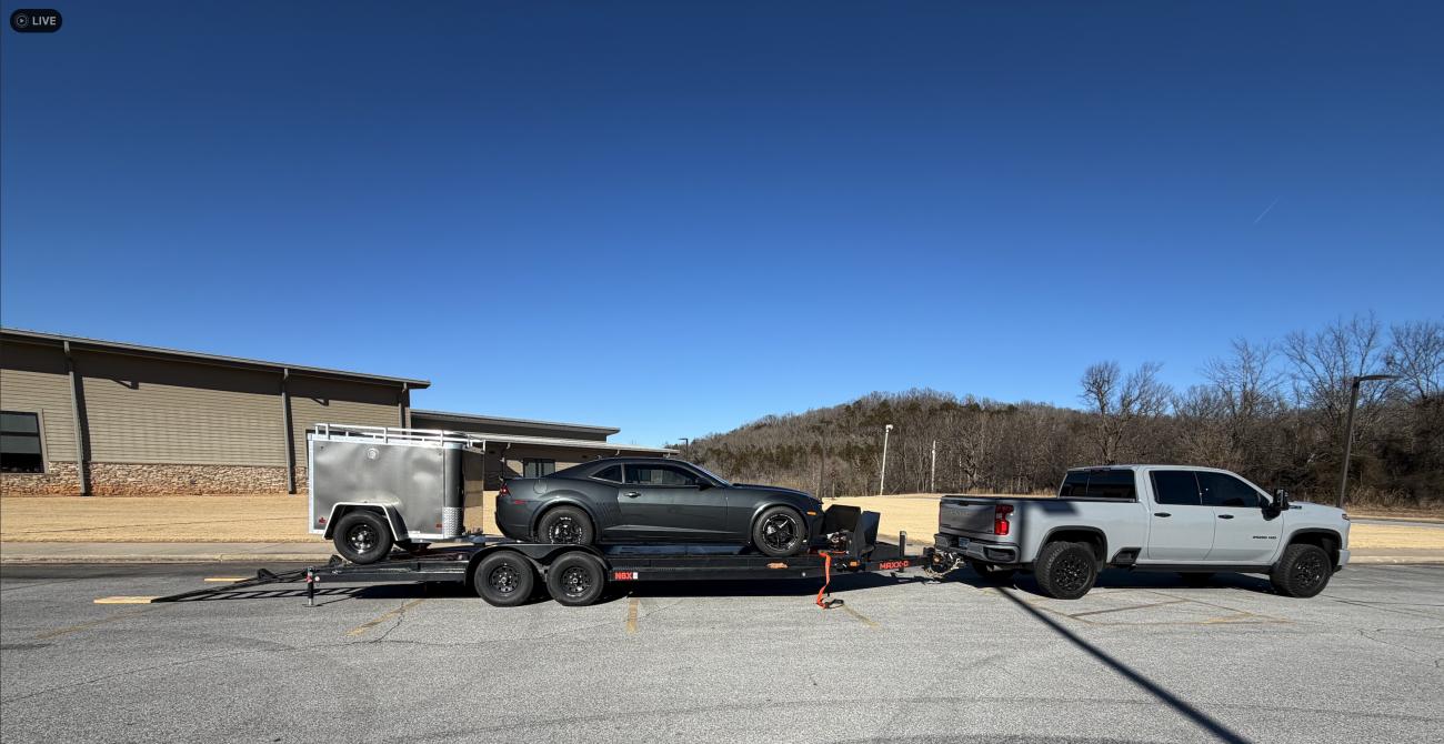

While getting things lined out for the trip the next thing to tackle was seeing how the car and little trailer fit on my car trailer. The car trailer is a 24' split dovetail Maxx-D car trailer. The actual useful length of the deck is 23'. Problem is that the car and little trailer are 26' in length.
So my buddy & I took them up to the community college just up the road to test fit all of this. The road I live in is a bit narrow and also is slightly up hill where we typically load. So figured we could use some space to evaluate things and not worry about people needing to get by at the house.
We just ended up loading the car on pulling the little trailer as far as we could. Then attached the winch cable to the little trailer and pulled the tongue up underneath the rear of the car. worked out well.

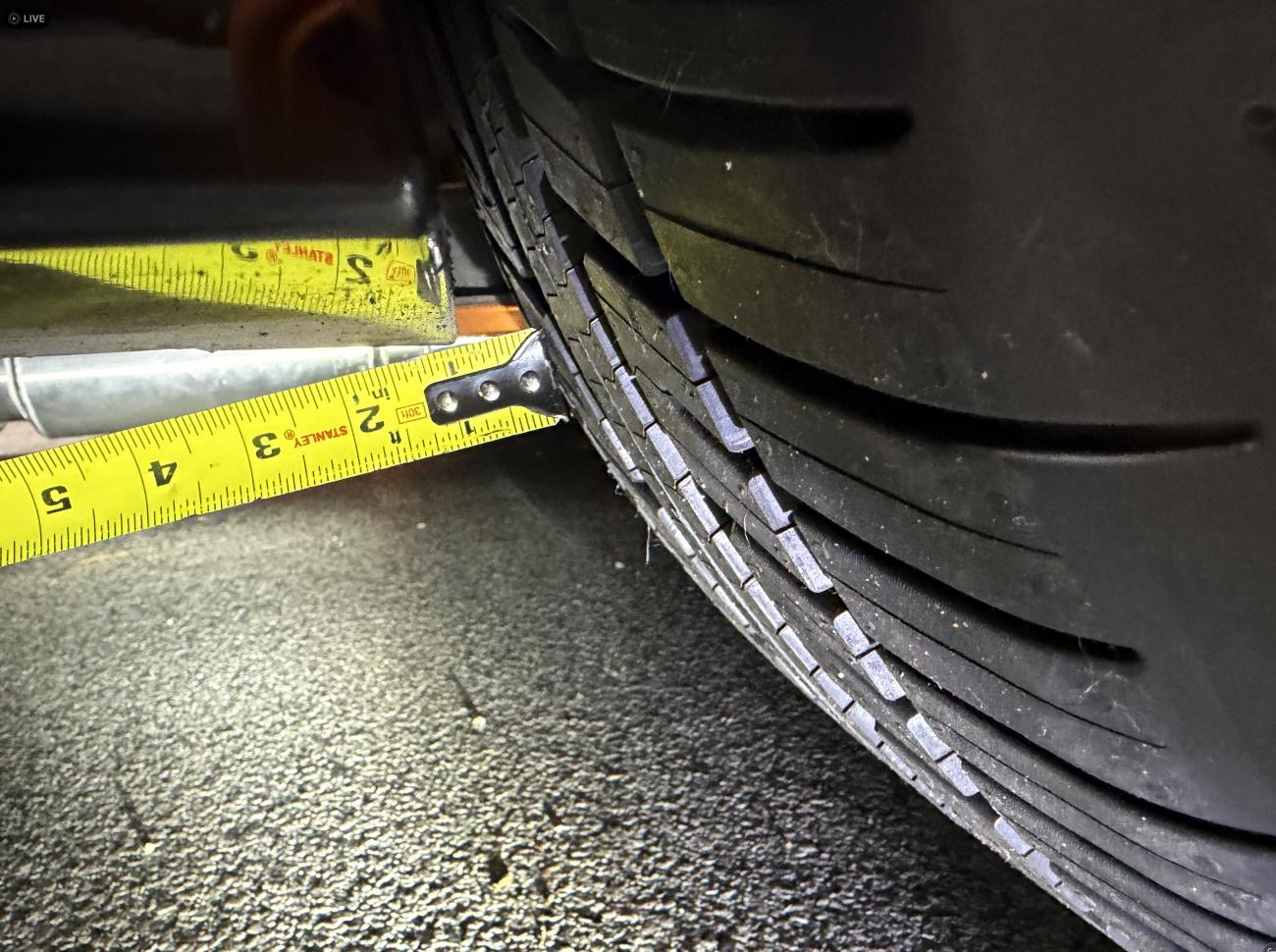

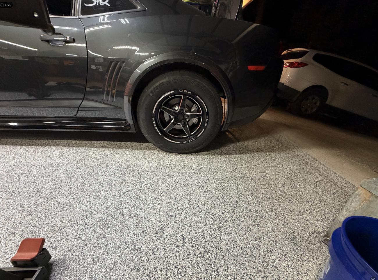

I decided to replace the 305/45/17 Mickey Thompson ET Street R's that I used to run around on with some taller tires to help with the drive portion of Sick Week. I ordered some BF Goodrich Elite Force T/A 265/60R17's which are designed for police vehicles. They are quite a bit taller, right at 30" tall and will help reduce RPM's on the highways, which will be higher now since going from 3.23 to 3.73 gear ratios.
They are a very tight fit like I figured and the only way to put them on is by jacking the car up under the lower control arm. They will not fit by letting the suspension extend at all.
You can see here in this pic with the 275/60/15's radials on and the suspension extended, that the inside of the rocker panel angles towards the tire. This is where the BFG's hit when the suspension is extended all the way.

On the car
Name:  Screenshot 2026-01-25 at 6.04.43 AM.jpg

Here is how close they are to the rocker when on the ground.
Name:  Screenshot 2026-01-25 at 6.04.57 AM.jpg
I have debated trimming the inside of the rocker to make some clearance. If I have time I might give it a try.
