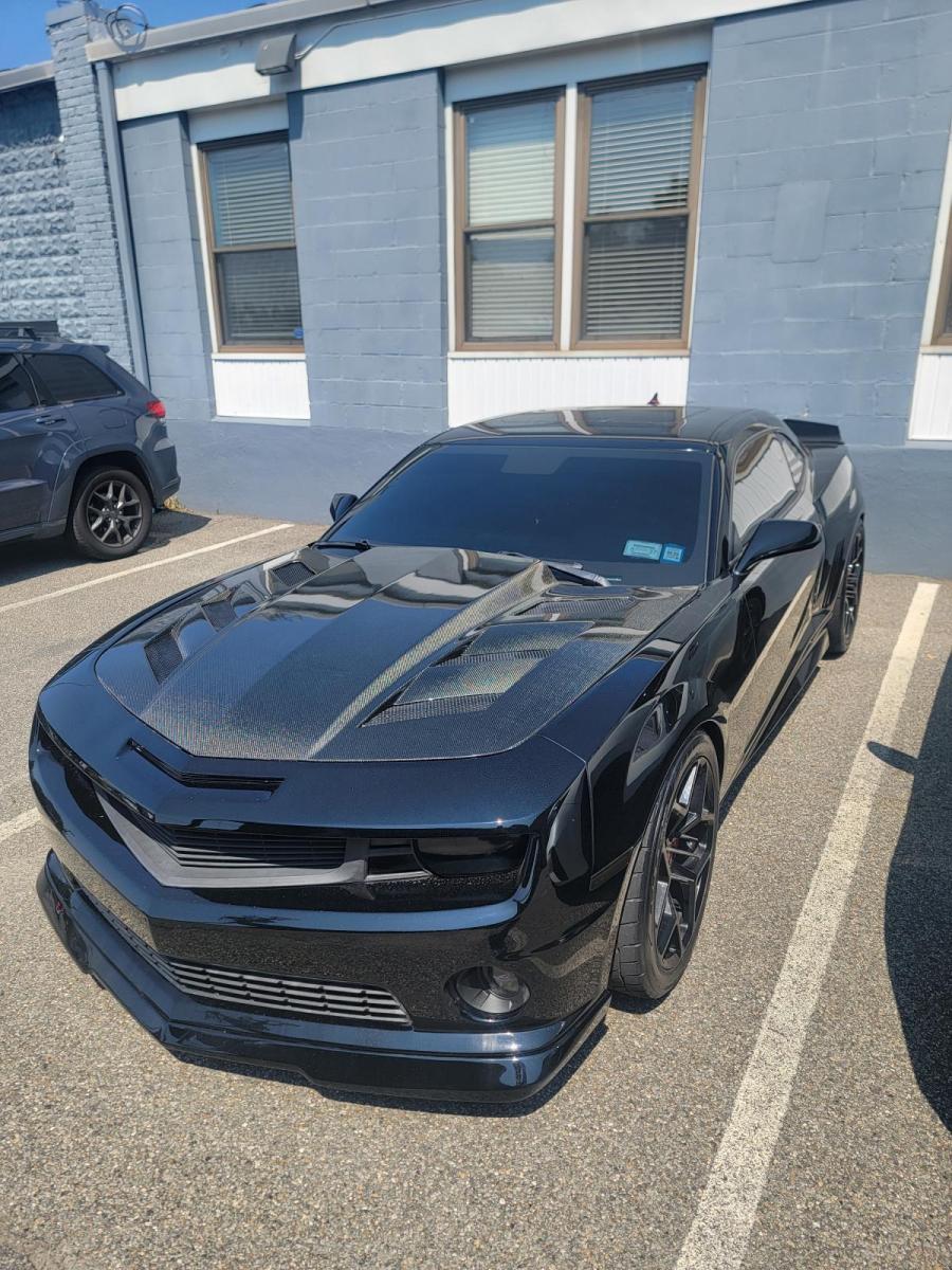

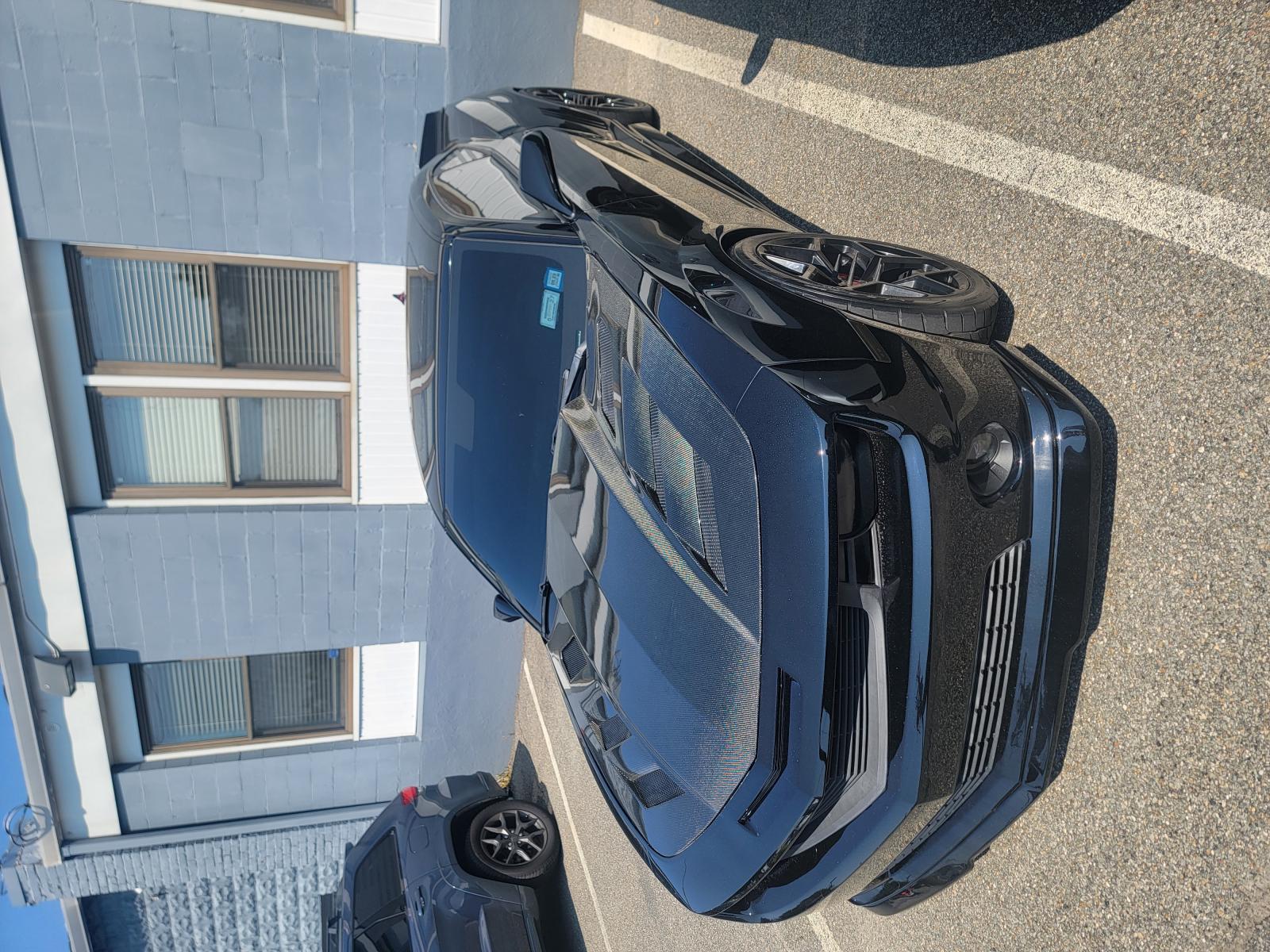

Exactly. This is her now. Yes, I know my pics are always sideways :(

Yeah - that looks more like it should. I am assuming that in making a VIS CF Part that they Clear Coat it, but I may be wrong. It may be just that they just polish out the Gel Coat. Did they sand and apply CC as a fix?
AI can be our friend:
"Yes, most high-quality carbon fiber hoods are clear-coated as part of their finishing process to protect the resin, enhance durability, and provide UV resistance, though some budget or custom pieces might skip this or use an integrated gel coat, requiring extra UV sealant or paint. The clear coat (often a durable urethane) is applied after molding, sanding, and prep, sometimes multiple layers, and is crucial for preventing the carbon fabric from yellowing or fading in the sun. "

Yep, Sanded down to the carbon and cleared. Looks fantastic and I love the hood, I just will never endorse VIS after the way they handled the issue.

Flipped them for ya.. You did a great job! Looks nice..
