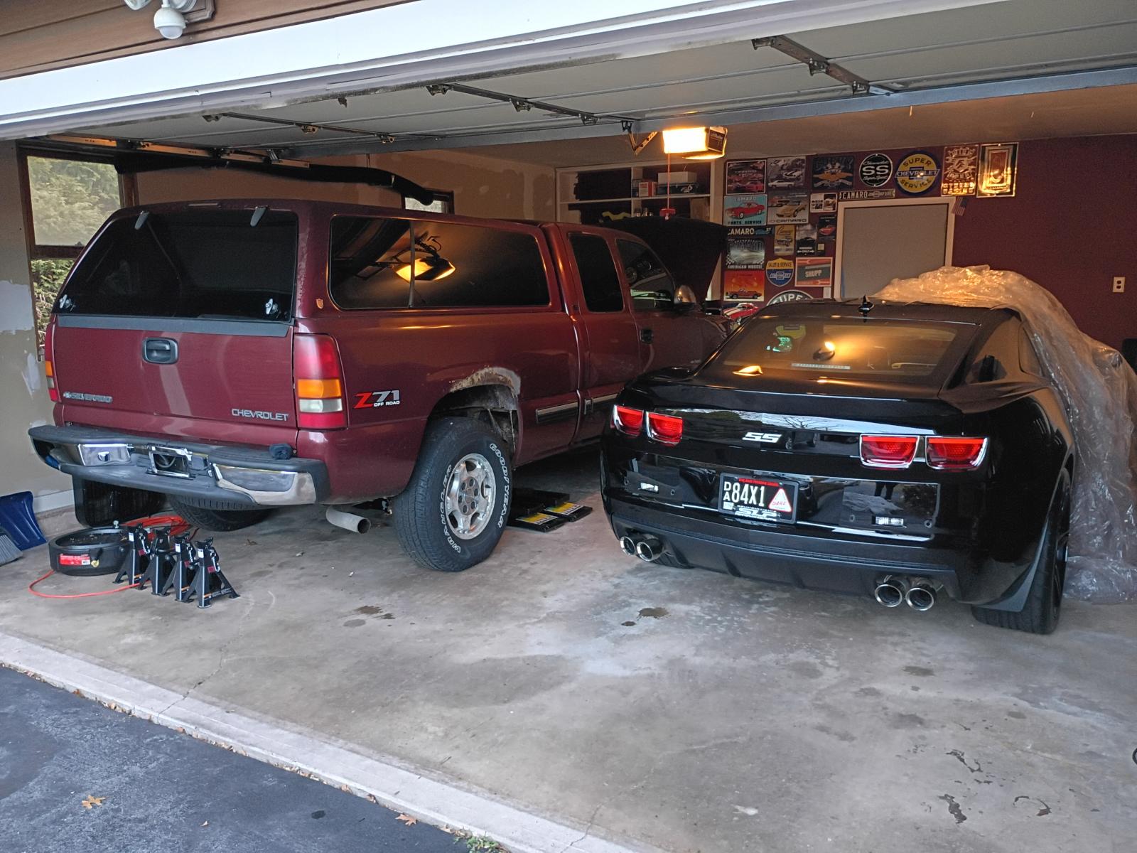

For the past 7 years every Christmas has been Camaro parts, gift cards for Camaro parts, Camaro signs, shirts, etc. 2025 was the Christmas of Silverado. My wife got me these awesome GP Audio battery terminals, if anyone has checked out my Camaro build thread, I'm big into grounds. I'll be following suite on this truck very shortly.
Dad hooked me up on a new front bumper and top cap assembly. Here you see a little preview of all my parts mocked up. I'm going to order all new bumper brackets, give them the battery tray treatment and get this installed. Might run like shit but man that chrome will be shinin'
Also grabbed this photo of both Chevy's running together, I filled the Camaro with Stabil and was letting it run through the system before the goes under the cover till spring. I truck was running for a fuel pressure test. More on that in the next post.

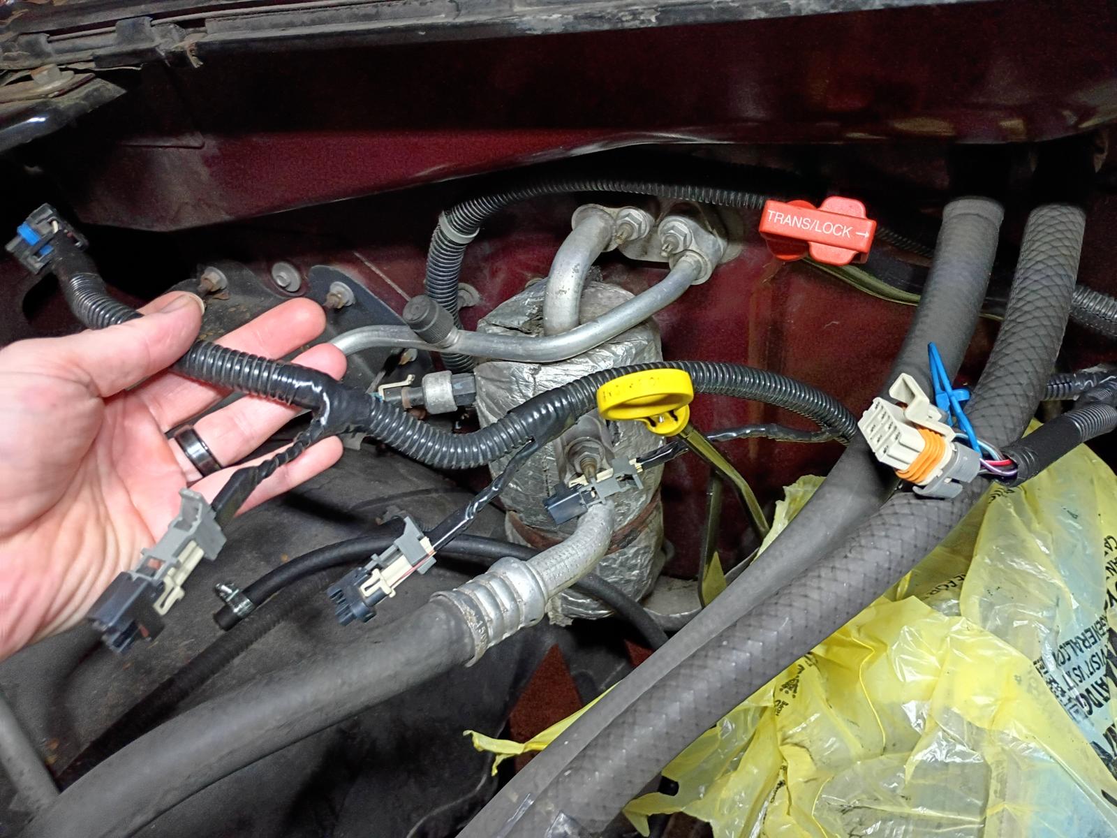

Forgive me if the next few posts overlap or even seem like I'm working backwards, its just how parts are coming in and how I took my photos. After the manifold removal I decided to tackle one side at a time. Passenger side first as there is far less harness to deal with.
First I unbolted the harness from the block and started cleaning. Most of the injector harness electrical tape was crispy and unraveling but the loom was ok. I gave it the same treatment as the front headlight harness and retaped most of it. Also cleaned the trans and oil dipsticks, tubes as well. Some of the firewall got cleaned by accident.
