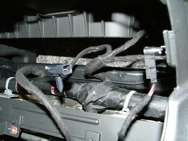

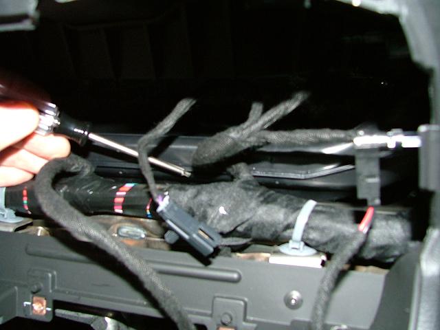

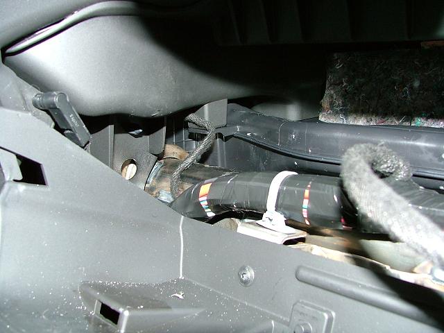

Has anybody located the missing power source yet? My car was built in December and also does not have the plug.

Check behind the speedo
I had the one on the drivers side in place. When I got behind the speedo cluster the other one wasn't wrapped in the main harness. Both connectors come out of that loom, my second one was wedged under the vent box for the defogger. I could just barely see it. A gentle pull on it's harness showed me it was just stuffed in there with some foam wrapping.
This is the harness it comes out of:
The torx driver is pointing where mine was hidden:
This is the connector harness coming out of the main harness on the left side:
Both ABL connector harnesses have a black and purple wire each. My TPW date was 09/21/09. The speedo connector was real easy to remove from the cluster, just push the tab and out it came. I put mine in the back seat so it was out of the way. Hope this helps.
