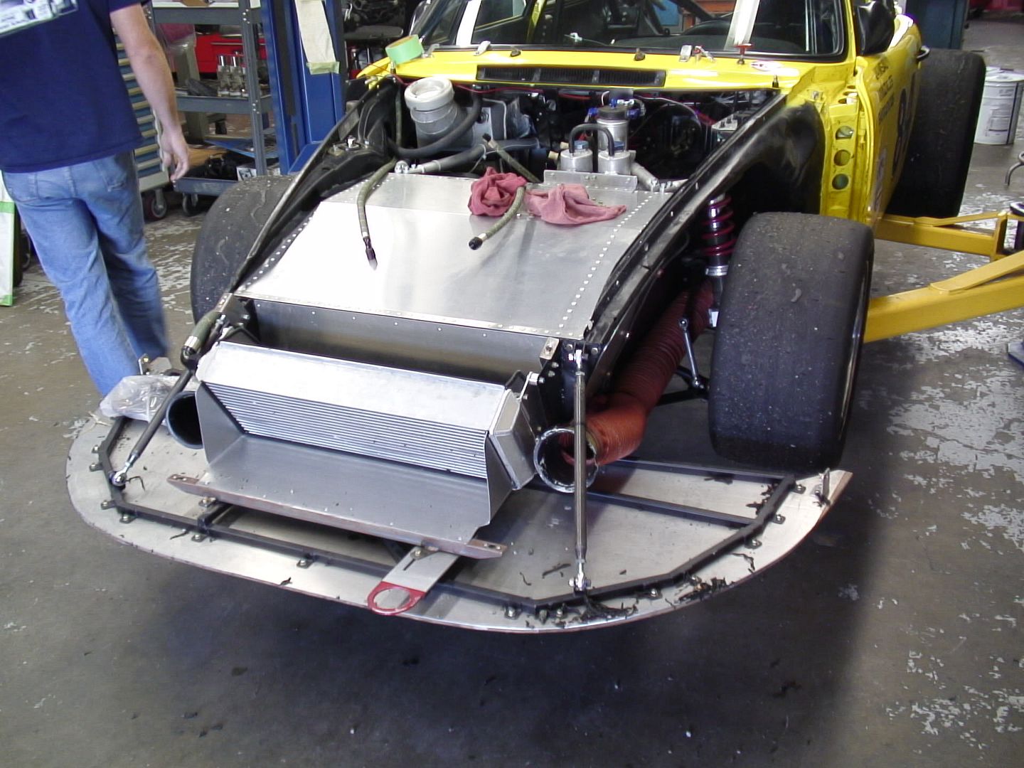

You do not need a turbo timer .. the car below... I race it a 1.2 bar it has 850 HP and I don't have a "turbo timer" on it and I get plenty of hard life out of my turbos....
Is there a pump on your turbo or is it gravity feed ?How are you returning/scavenging the oil out of the turbo?

I don't want to step on this thread .... this is my factory Porsche 935 . I race it in vintage including events like the Monterey Historics at Laguna Seca .. 2300 lbs wet
