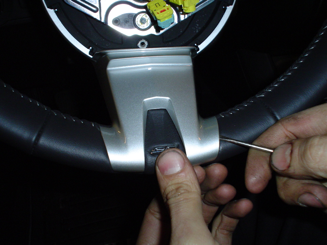

first step as always is to disconnect the battery so as to not set off the airbags. dont be afraid of them if you are careful they are not a problem with no power. there is a small hole in the side of the steering wheel insert a small tool i use a flat blade pocket screw driver and push in on the metal tabs i took pics of the tabs w air bag off to show you what you are pushing against

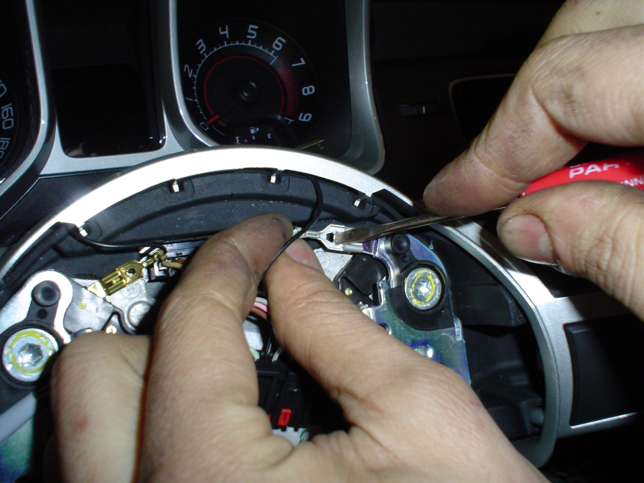

next remove the air bag connectors using that same screw driver carefully pry under the retainer to remove then pry up on connector and it will come lose same for both connectors

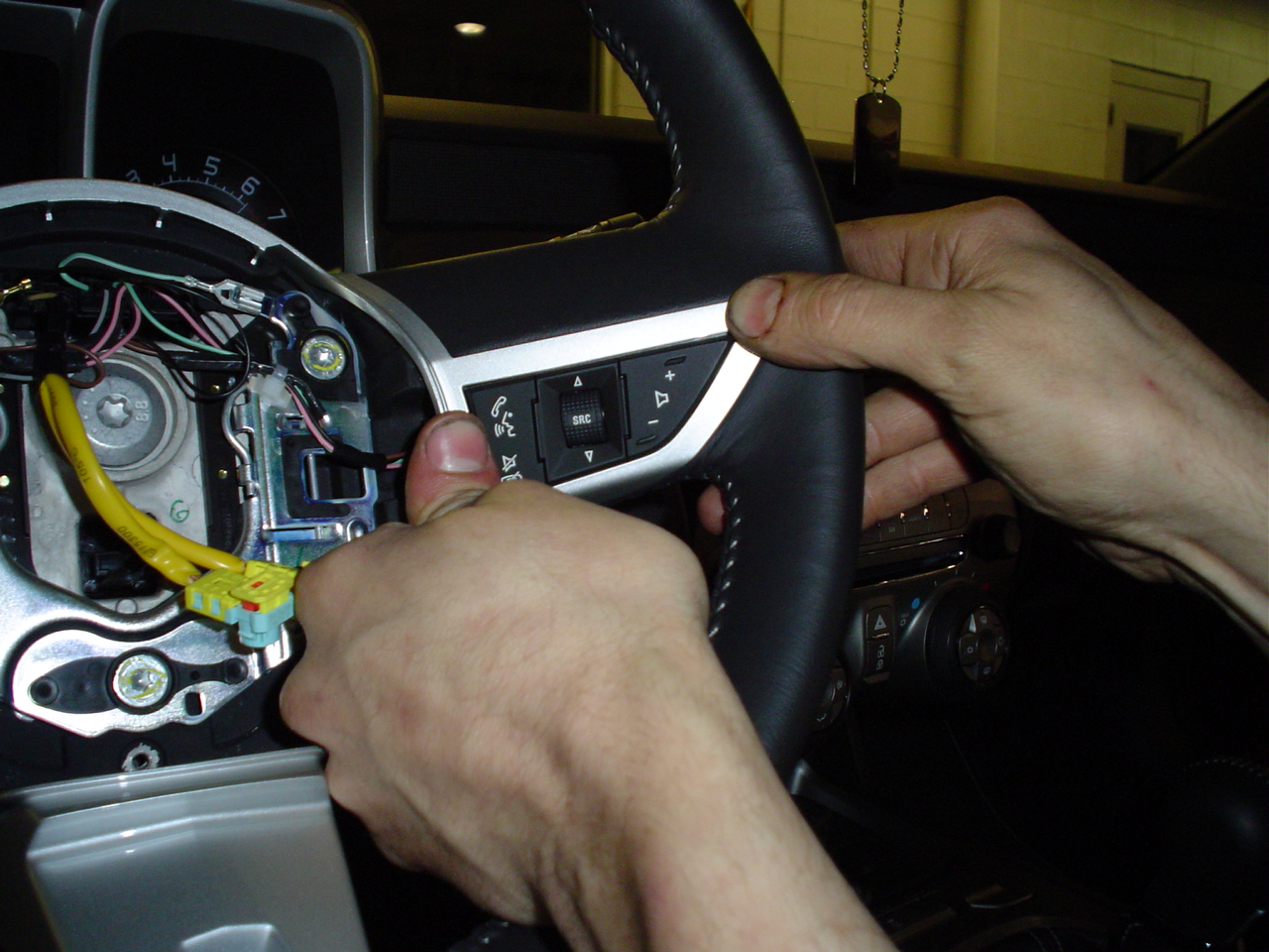

next disconnect the wires by pressing in on one wire connectors and releasing retainer one going to steering wheel coil

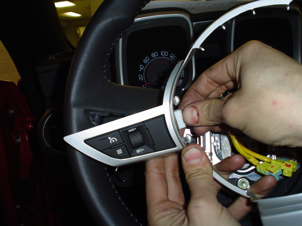

next cut green tie strap or whatever color is there holding harness to wheel new harness comes with new retainers. then the fun part removing the silver trim ring around wheel basically it is just pressed into the rubber in the wheel. carefully pry it loos around the edges and it will come out

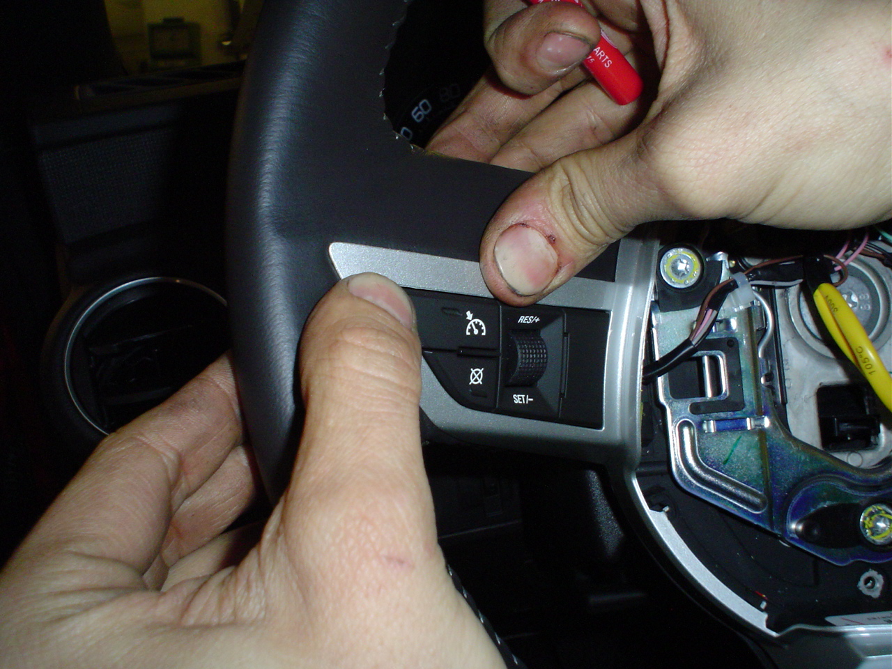

next remove the blank filler on right side of wheel and install new switch. next unplug harness from left switch and discard. install new harness to switches and press the silver trim ring back into wheel startin at inside of switches and moving out

then install new wires onto retainer making sure not to pinch any wires black on left green on right. then reinstall the air bag connectors pushing them in first then pushing in retainers fully finally just line up airbag and push it onto wheel firmly. reconnect battery and get your bcm programmed at dealer. side note the switch light will work right away but not the features themselves until you get it updated
