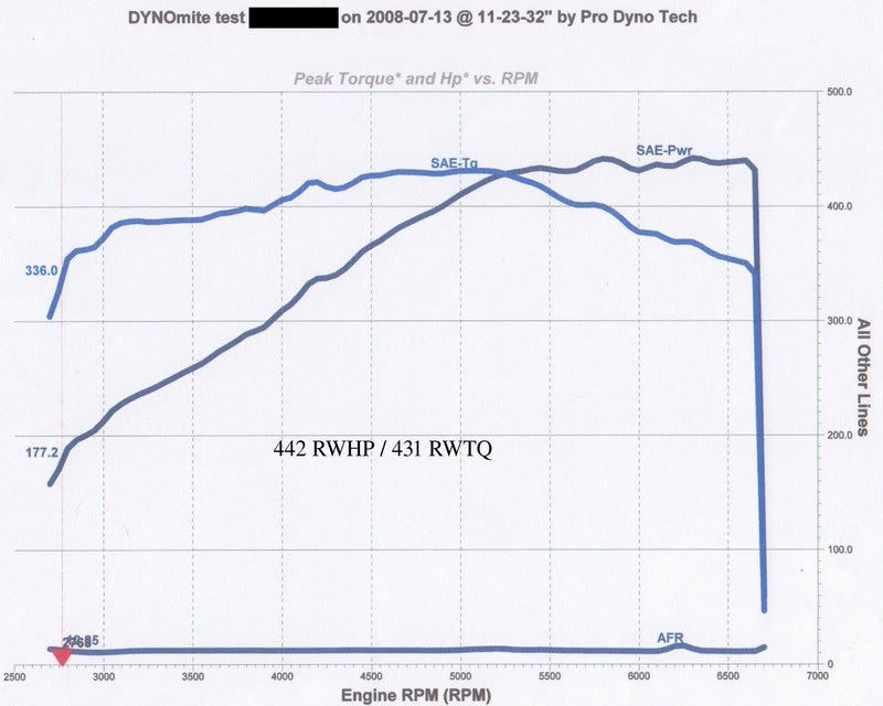

Originally Posted by baileyrx View Post
peak torque & hp, always occur at different RPM's so you need to do the formula twice!
No you don't. HP is calculated from torque. See below. This is the dyno graph off my friend's Paxtoned LS3 C6. Note where the lines cross.
This is his girlfriend's C6. Same setup plus headers and a little larger pulley.
And so on and so forth. Dyno graphs will always cross at 5252 because HP is always (no ifs, and's, or buts) calculated from torque.
