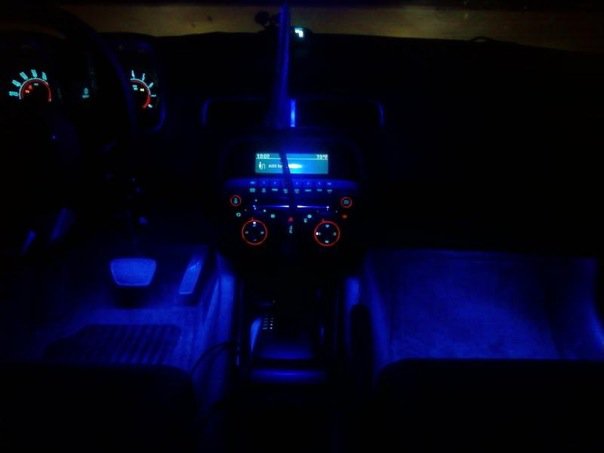

i DID MINE!! looks swweettt ur directions helped tremendously tony heres the finished product

All look great!
