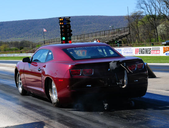

The new 2010 Camaro, despite a lot of interest from the public since their unveiling and strong sales numbers to date, has been slow to infiltrate the drag racing scene. But if racers like Bellwood, Pennsylvania’s Mike McCracken keep churning out the sharp new GM muscle car, they’ll surely catch on.

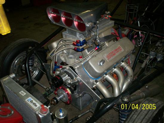

McCracken’s Camaro SS – completed in just four months time in his garage – sports a 600 cubic inch, alcohol-injected Big Block Chevy producing 1,013 horsepower, backed by a three-speed Powerglide transmission. It delivers the power to a 9” Ford rear-end with 4.30 gears.

The mild steel, full tube chassis is a Morrison Super Car, which was originally being built to accommodate a 1969 Camaro body before Mike acquired it. The chassis features Strange Engineering front struts, Wilwood disc brakes, and a Super Series four-link with Koni coilover shocks.

The car will see duty primarily in Super Pro competition, along with some possible NHRA Super Gas races. The car is expected to run in the mid 8’s, making it perfectly suitable to either racing application. The car turned out a little heavier than McCracken anticipated – around 2,900 pounds – due to the factory body panels and glass which may keep it from the mid-to-high 7 second range that he had hoped for. “But I gave up the weigh for the look,” he said. “When we took it to the track the first weekend, people just went, wow!”
